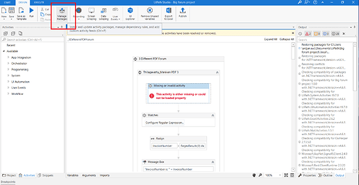

BTW you have to install PDF Activities from Package Manager:
If it’s not working just change the file path to the Read PDF and Read PDF With OCR activities
Big forum project.zip (141.2 KB)
This one is with edited file path
