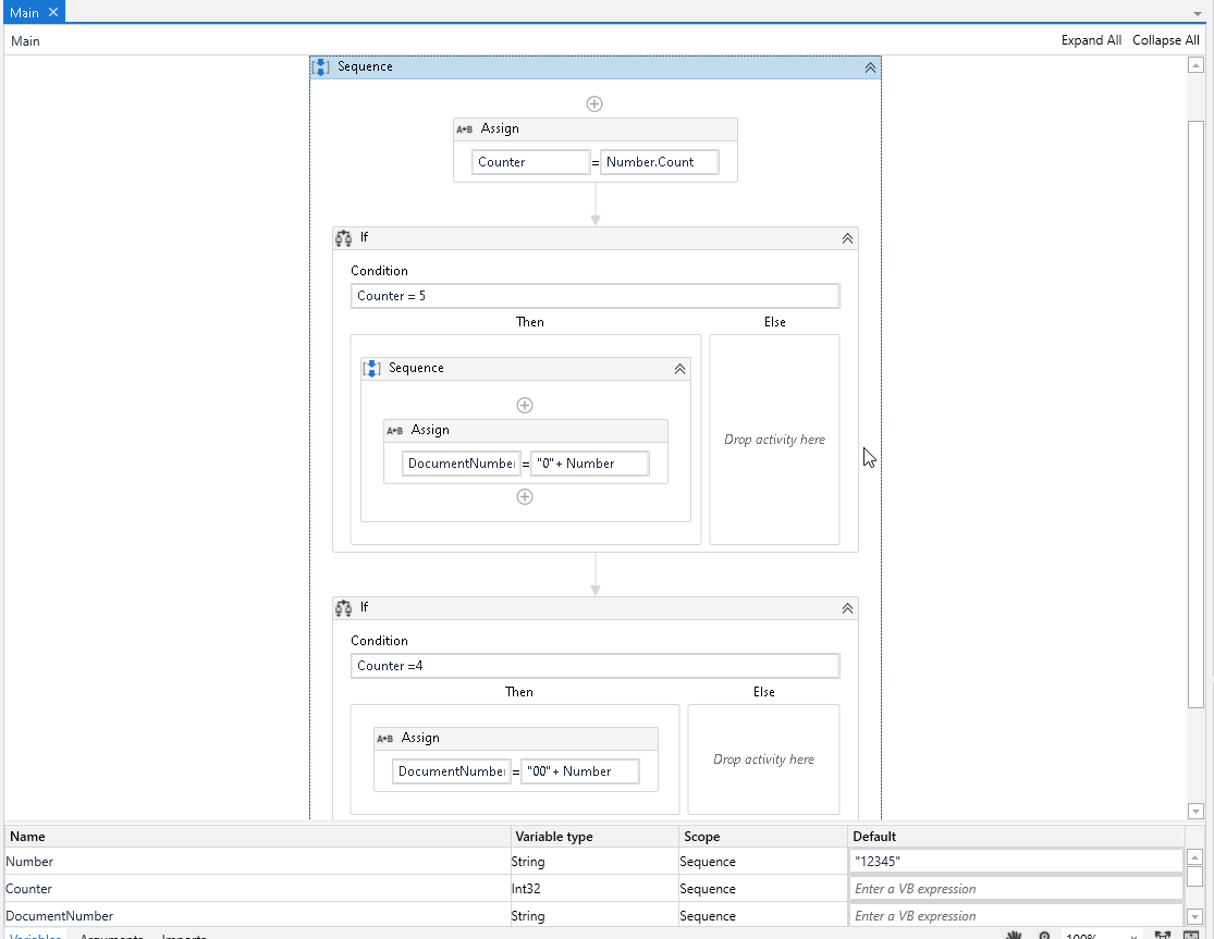

The first solution that come in my mind was this:
Create variable to store the number of digits.
Multiple IF statements where I check the length and
these IF statements will be repetitive until IF Counter = 1
The second one itβs almost the same. I think itβs not good idea, because itβs not even easy readable for the human. In every ELSE statement inside of the IF statement, I put a new IF statement for the next length.

It looks like you want to react on the numbers individually
Have a look on the switch activty
From the understanding of you want to achieve that you want fill up on begin with zeros. So this can be done with the padleft function and you can avoid the nested if else
UPDATED:
And if the goal is to full up a tring to certain length with 0 so it can be done directly with padleft on the string:

But the most simpler solution was: Number.padleft(6,CChar(β0β)).
Always fill the first digits with zero based on the max length. In this case itβs 6.
