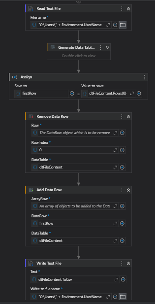

I have a text file that i need to move the first row to the last row.
My problem was im getting an output of comma and the value of first row was missing.
I have attached a photo of sequence and sample text.

can you share the output of generate datatable activity

I’m new to UiPath can you explain about your code how it works? I haven’t tried yet because it really advance to me.
Thank you I will looked into your share. Can you explain why my sequence was incorrect and giving me an output of a comma.

i think the sequnece which you have implememented was correct.
can you debug the process by placing break points and check the output after each activity,So that you can figure it out where it went wrong?

The first row output is for assign: firstRow = dtFileContent.Rows(0)
The second row output is for Remove Data Row Activity.
The third row is after Add Data Row Activity.
My question is why is the firstRow value deleted even we assign to a variable?
