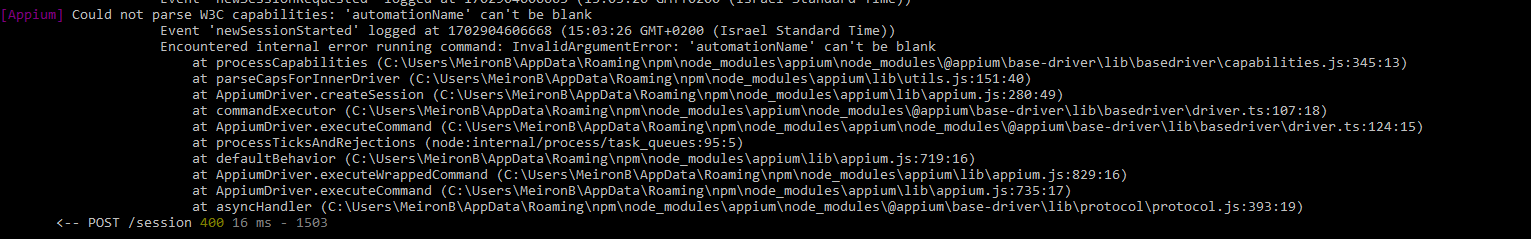

I got this error

This is what display in the CMD
you didn’t install the android driver. Your instance of Appium is just a dump instance:

these are the details
The details of the driver install command. These are from starting the session.
