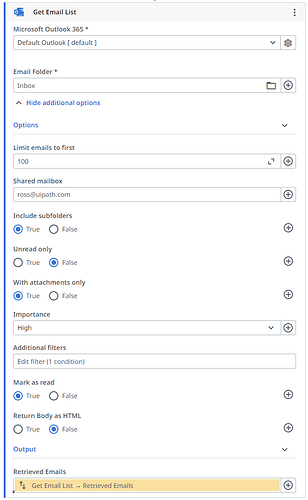

I was using the “Get Email List” activity from MicrosoftOffice365.Activities and I noticed that I didn’t have some options that should exist per the documentation of the activity.
Here are the properties that I have :
When we look at the documentation Activities - Get Email List we can see that there are properties that are missing in my activity, such as “Return Body as HTML” :

Looks like this is removed in the latest version of the package…the second acreenshot you shared is a studio web screenshot…if you open the studio web now and check you would not have that option there also…so that property might have been removed or might be missed in the latest release
But you can still get the body as html …just use the output of the get email list activity in a loop and use currentItem.BodyAsHTML
Or to check sayt he output variable is emllist…then emllist(0).BodyAsHTML will give the required email body as html
It would have been removed because it does not add any specific value as the html body can be retrieved anyways
But I do agree the document might sometimes be misleading.but it is a continuous process

This is what I used (the .BodyAsHTML), but I wanted to make sure that this option didn’t affect the output of the method BodyAsHTML.
Thank you for the clarifications.
