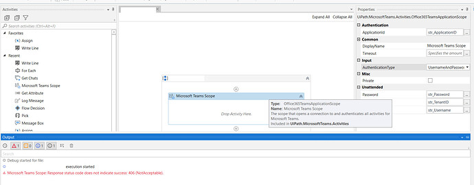

Hi there.
Please support with the bellow issue.
Setup is performed according to UIPath documentation :

Hi - can you please provide the error log file that we can take a look at? Also please confirm the versions of Studio and the activity pack?
Hello and thank you for your reply.
I am using Studio 2020.10.2 , Microsoft Teams Activities 0.4.0 and Mail Activities 1.8.6.
Bellow i have attached Error Log:
“17:05:27.9150 => [ERROR] [UiPath.Studio.App.Logging.OutputLogger] [18] Microsoft Teams Scope: Response status code does not indicate success: 406 (NotAcceptable).
17:05:27.9806 => [ERROR] [UiPath.Studio.App.Logging.OutputLogger] [1] RemoteException wrapping Microsoft.Identity.Client.MsalServiceException: Response status code does not indicate success: 406 (NotAcceptable).
at UiPath.MicrosoftTeams.Activities.Office365TeamsApplicationScope.Execute(NativeActivityContext context)
at System.Activities.NativeActivity.InternalExecute(ActivityInstance instance, ActivityExecutor executor, BookmarkManager bookmarkManager)
at System.Activities.ActivityInstance.Execute(ActivityExecutor executor, BookmarkManager bookmarkManager)
at System.Activities.Runtime.ActivityExecutor.ExecuteActivityWorkItem.ExecuteBody(ActivityExecutor executor, BookmarkManager bookmarkManager, Location resultLocation)”
Thanks @pibo. @Bhushan.Khadpe, can you please take a look & assist?
@pibo is this error happening during the execution of the scope activity or during execution of a teams activity in the body of the scope and if so, which activity?
Hello @Bhushan.Khadpe and thank you for your reply.
Error is happening during the execution of the scope activity (Microsoft Teams Scope).
