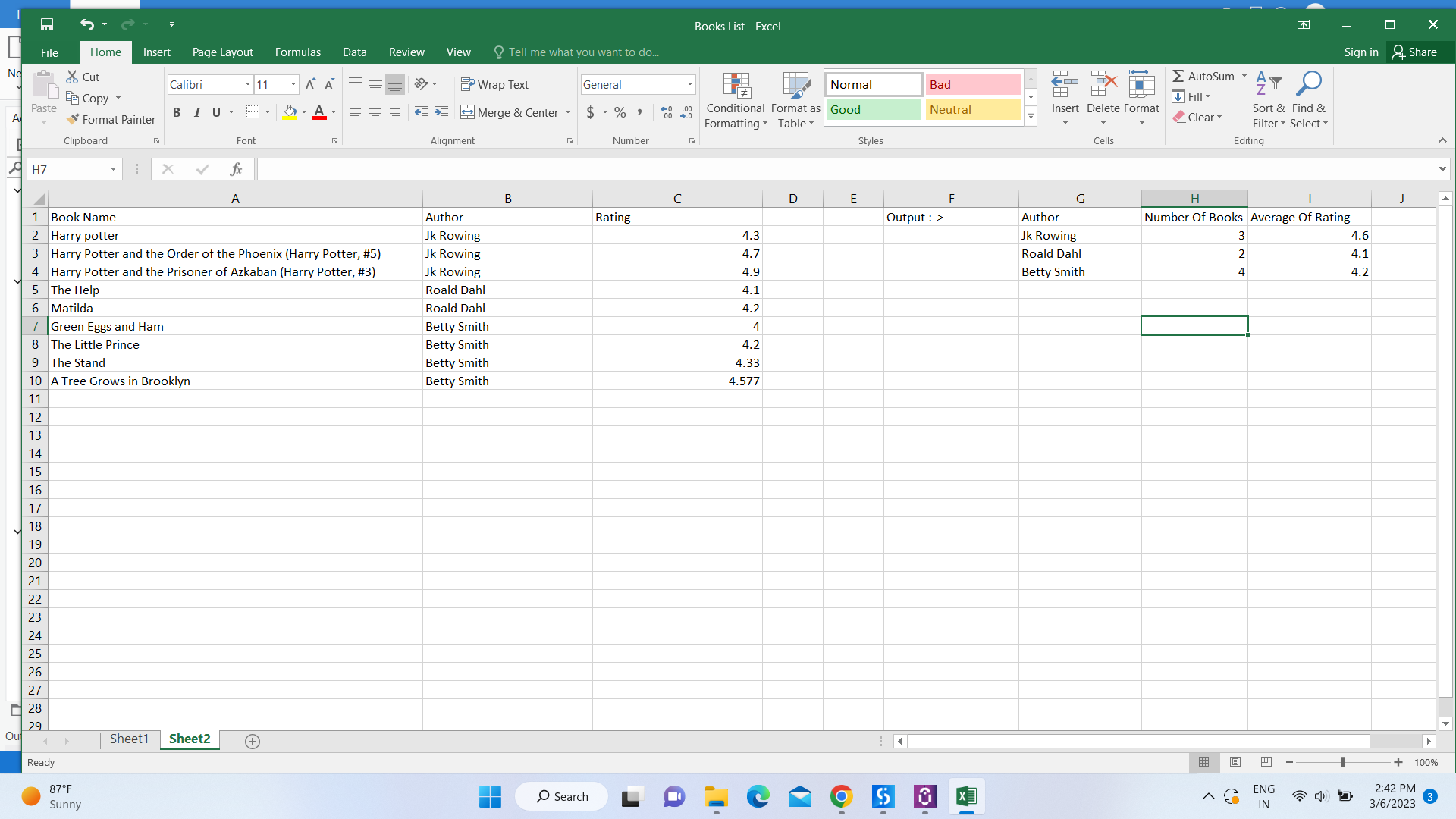

Merge Duplicate And calculate the Number of Duplicate
  1. Merge the Duplicate Rows
  2. Calculate the number of duplicate rows
  3. average of numbers ( Rating )

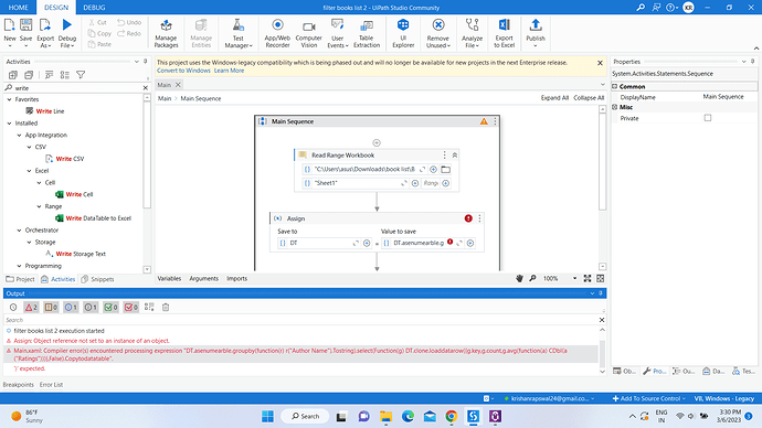

While Merging all the other Value are deleting
How to do it can some give some kind of Hint

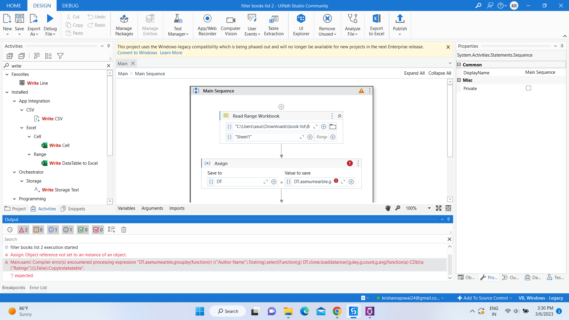

DT.asenumearble.groupby(function(r) r(“author”).Tostring).select(Function(g) DT.clone.loaddatarow({g.key,g.count,g.avg(function(a) CDbl(a(“Rating”)))},False).Copytodatatable
Error

Books List.xlsx (14.3 KB)
This is the Excel File if you run this code the output is come Same as Input

Hi @Krishan_Rapswal
Verify the output
Books List.xlsx (16.3 KB)
yes Correct
