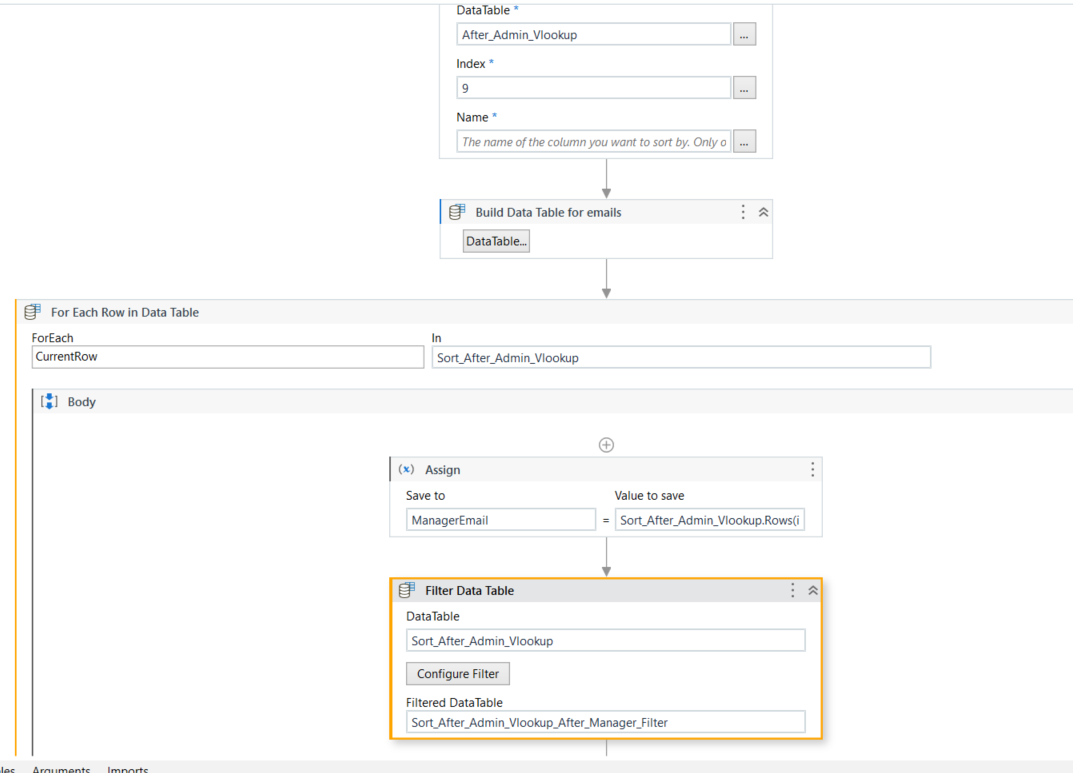

I have attached the part where we generate emails.
How can I create a loop to ensure that both departments head get cc-ed in the email?

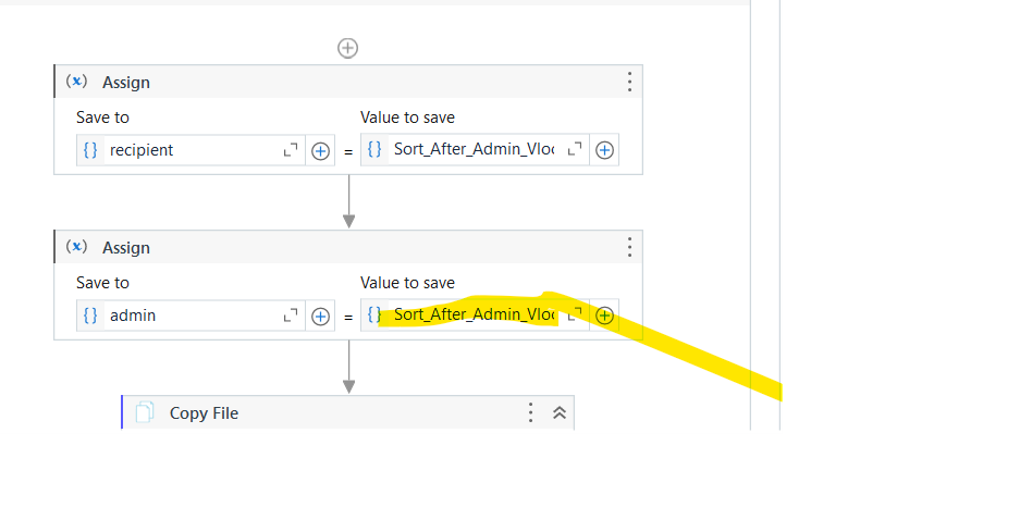

Hi @Anil_G, thanks for the quick reply, sorry may i ask where should i add this?
@weelearns
Here
cheers

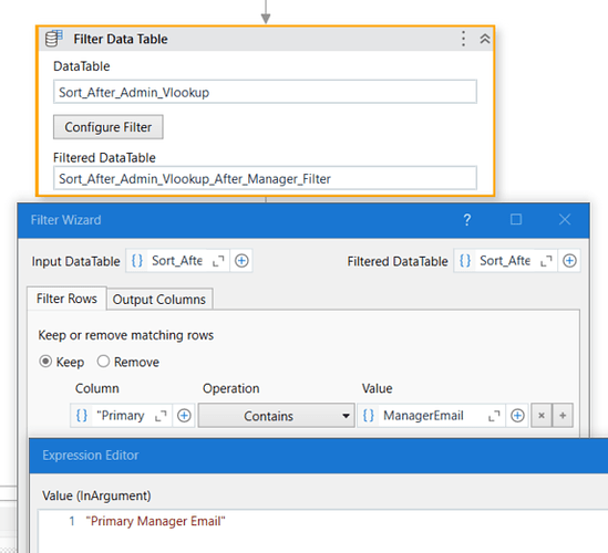

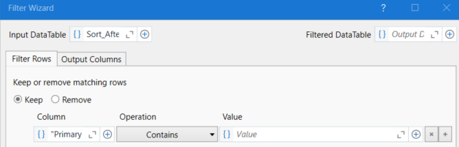

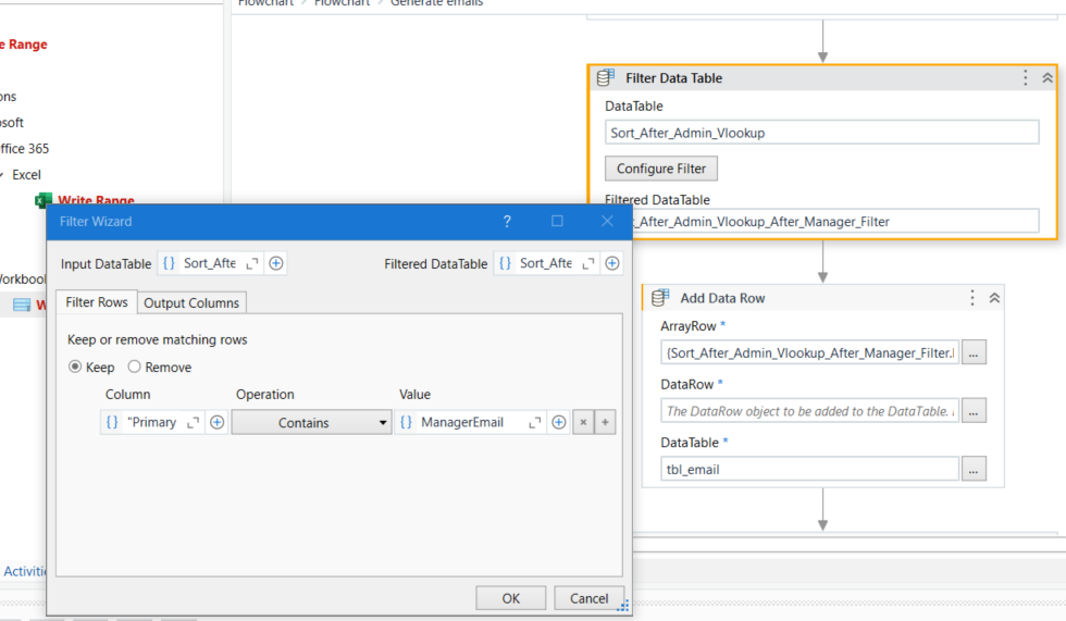

@Anil_G, i tried to filter by manager email, created a variable above. is there soemthing wrong with the way i filter the manager?
but got an error at the next section - Add Data Row: There is no row at position 0
@weelearns
I guess you are trying to filter manager name with manager email…
Can you check that

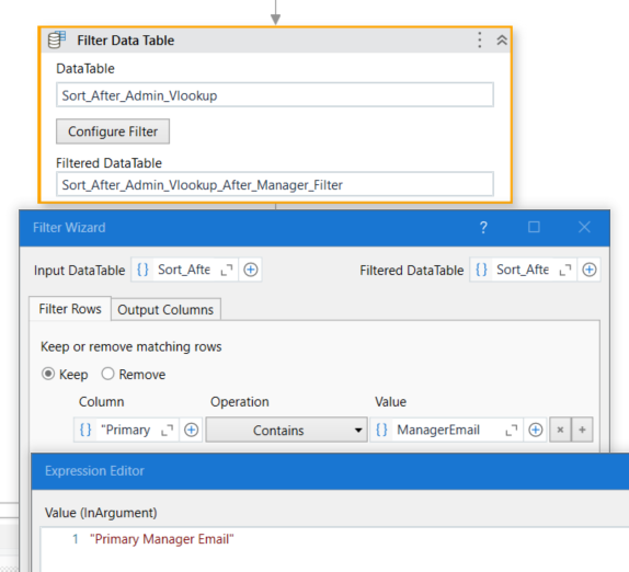

Hi @Anil_G, is this correct?

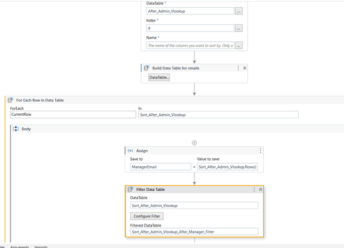

How can i make it into a loop too ? I have added it under for each row, i hope thats correct
@weelearns
I hope in the loop you are getting each manager…
Else you can get unique manager list in a separate datatable amd then loop on it
To get all unique managers list use uniquedt = inputdt.DefaultView.ToTable(True,"Primary Manager Email") - this has to be used in assign
Hope this helps
Hi Anil, i tried both methods but still unable to run the script…
Flowchart.2023.03.21 - Copy (1).xaml (34.7 KB)
