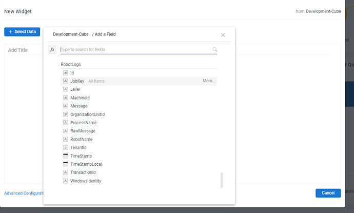

Hi. I try to build a dashboard using custom data. “Log field” data are defined in my process (“Add log field activity”).
I can see the table of the Process- in insights and only some of the “Log field” . There are a number of “Log field” that are sent from the process but are not seen in the table(Select data). I tried to rebuild the tables, I tried to update the tables. Nothing helps, only some of the fields appear.

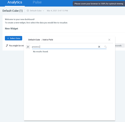

I have the same problem, I added “add log field” but I can’t get the logs in Insights, and I cant find the process by typing proces-
I can see the logs in raw message though.
is there any solution?

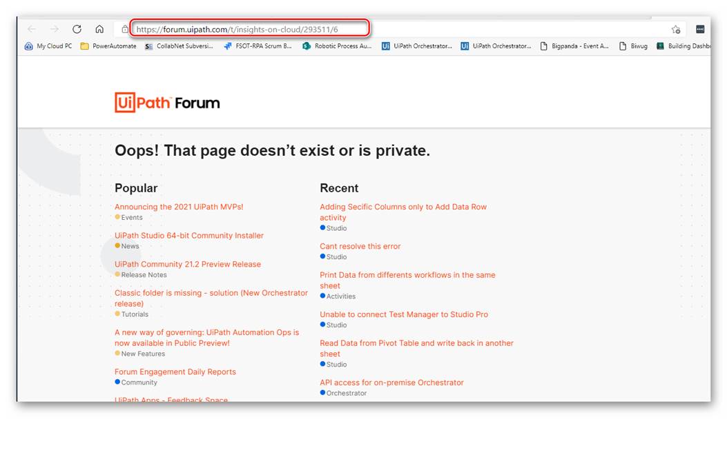

The link https://forum.uipath.com/t/insights-on-cloud/293511/5 doesn’t seem to be valid. Can you provide another link where you provided suggestions that you thought may be helpful? Thanks.
Hmm…it’s valid for me, but try: https://forum.uipath.com/t/insights-on-cloud/293511/6?u=michelle_yurovsky
Sorry guys, it turned out it was a private topic sent to me by someone and I had a thread going there. Summary of my points there:

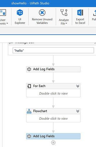

I followed the instructions to add custom data into insights, but I still don’t see any custom data on it. We are currently using version 2020.4.2. Do we need to update in order to see custom data?
Hi Carlos,
Did you run the process through orchestrator or the assistant? Can you confirm that you see the process name in Insights? Also, you added the log before the custom fields are added and did you make sure not to remove the custom variables before the last log?

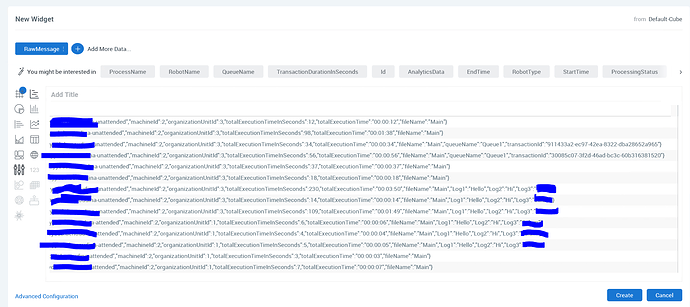

I ran the process from orchestrator, the assistant and studio. I don’t see the process name in insights. This was the entire process in main, I was just testing all these activities to get some custom data in insights.
In that screenshot, I do not see the searched process, but if you tried searching for the process and do not see the process name then we may have a problem with the connector. The tenant setup logs will let you know if the connector failed if you want to give that a try. Otherwise, just file a support ticket and they’ll help.
