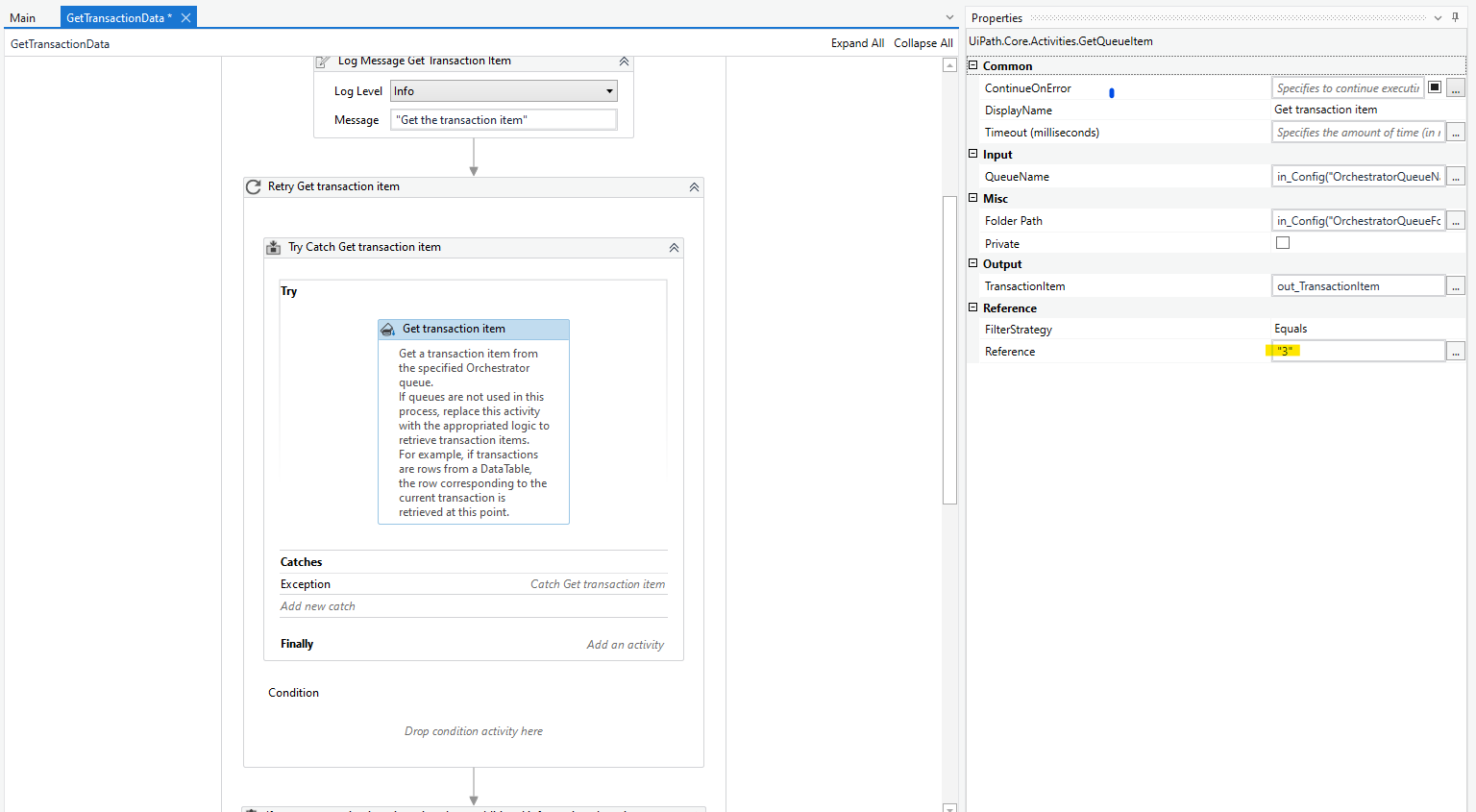

If you’re using REFramework, you can still integrate the code I did provide before, to get a list of all the items in “new” state, and all the items in “new status” (in 2x different requests).
For each item in progress, if the list of “New” items has any of the same reference, you remove it from the list, meaning that you remove all the New Items, that have a “In Progress” item with the same reference:
Simulation:
1,2,5 are running, therefore I remove them from the “New” list.
When you’ve decided that “3” will be your next item since it is the 1st one found, and not running, you send it to the “GetTransactionItem” as Reference Filter:
Hope this is what you need now.
If I’m not getting it correctly, please if you could provide more information, it would really help!
