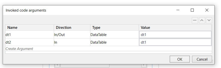

Hi @radhagangwani0
you can try this code in invoke code with dt1 as In/Out
dt1.AsEnumerable().ToList().ForEach(Sub(row) row(“Column2”)= dt2.Rows.IndexOf(row)+1)
dt1 and dt2 should be arguments passed as
Nived N
