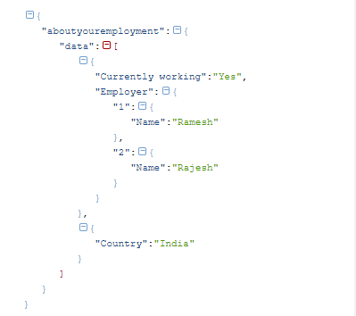

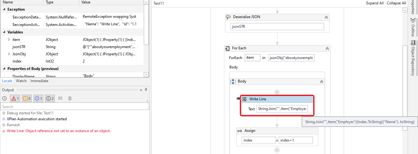

I am facing some problem on parsing JSON Array. Need your guide line.
JSON
JSONFile.txt (177 Bytes)

Same error.
Hi @anand.t,
I cannot see what you have in your For Each but you might have missed the “(0)” before Employer. This is because data you want is within a json array and you only want to focus on the 0th element of that array. Within that 0th element, you have a key name Employer.
Short Solution using Message box:
JsonString("aboutyouremployment")("data")(0)("Employer")("1")("Name")  ---> Ramesh
JsonString("aboutyouremployment")("data")(0)("Employer")("2")("Name")  ---> Rajesh

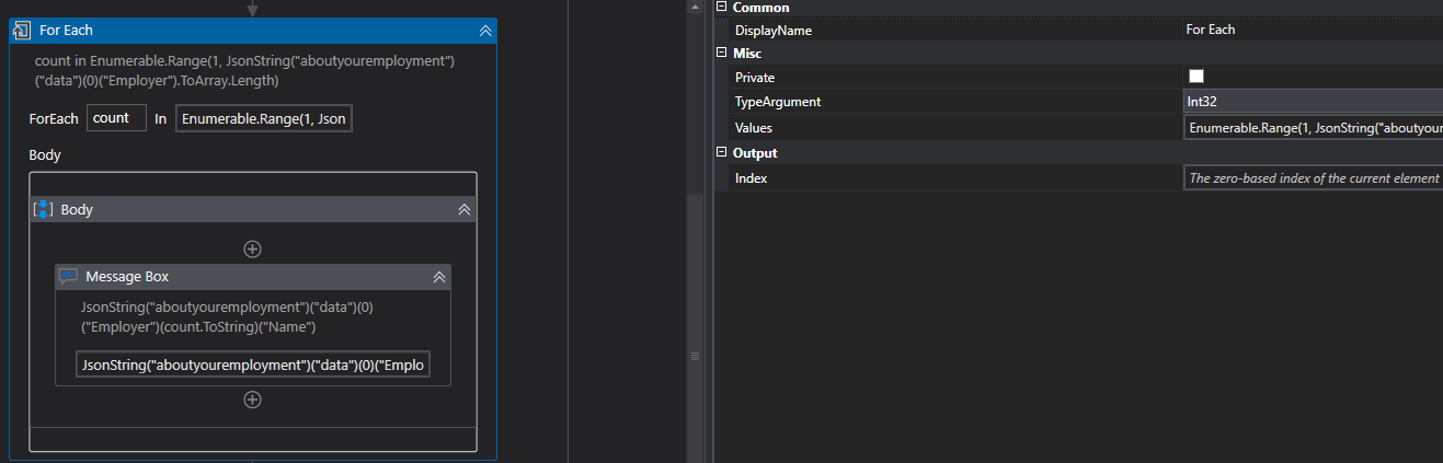

Here are two alternatives to get to your solution:
First alternative using the length of Employer:
Second alternative- Property → Object using two for loops:
Here is the sample xaml file for you to refer :
JsonParsingSample.xaml (11.2 KB)
JSONFileSample.json (450 Bytes)
Hope this helps clear your doubts.
