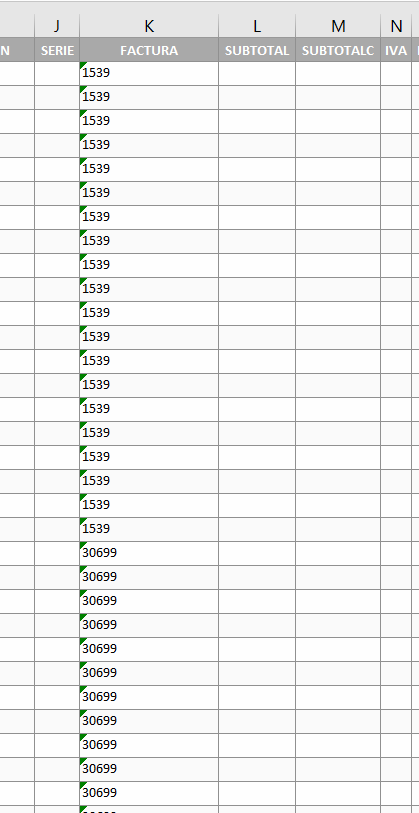

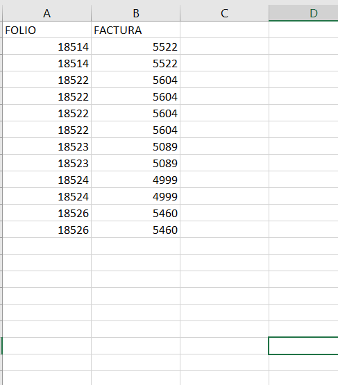

But if you closely look at the excel file the datatype of FACTURA in Hoja2 and Hoja1 are different.
in Hoja2, FACTURA column datatype is in Number format.
in Hoja1, FACTURA column datatype is in text (String) format. So you can see a warning symbol in FACTURA column of Hoja1.

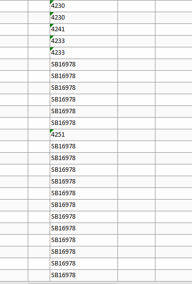

So at first i thought FACTURA Column has only Numerical datataype as per information in Hoja2 sheet. But when looked into Hoja1 sheet, it was found that apart from the Numerical datataype FACTURA column value, there are some alphanumeric values also there (screenshot below)
So it was better to convert the FACTURA Column of both sheet into String Datatype.

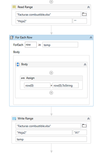

So in the first part of the workflow, there is sequence which convert the datatype of FACTURA column of Hoja2 sheet from Numerical to String.
Rest is the same way as u had did
