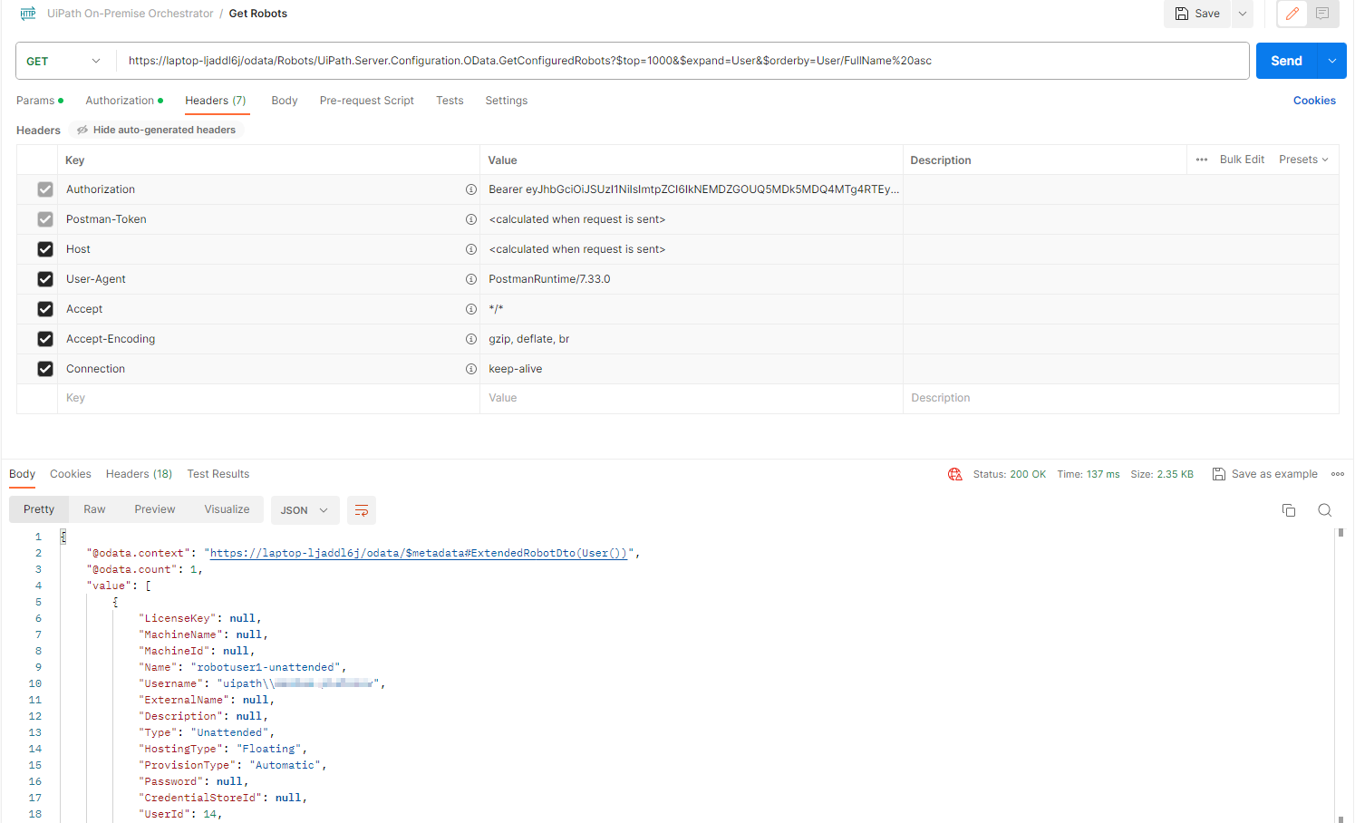

For getting details of the robots, check this approach
Use the Host/Tenant tenant retrieved bearer token.
POST to https://YOUR_Orchestrator_URL/api/account/authenticate
Body of type JSON
    "tenancyName" : "Documentation",
    "usernameOrEmailAddress" : "Documentation",
    "password" : "DocumentationAPItest"
Get the robot details by using
GET for https://YOUR_Orchestrator_URL/odata/Robots/UiPath.Server.Configuration.OData.GetConfiguredRobots?$top=1000&$expand=User&$orderby=User/FullName%20asc
