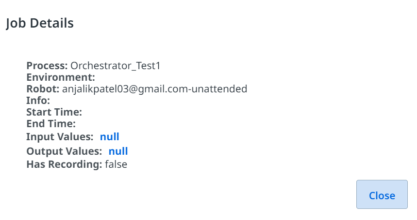

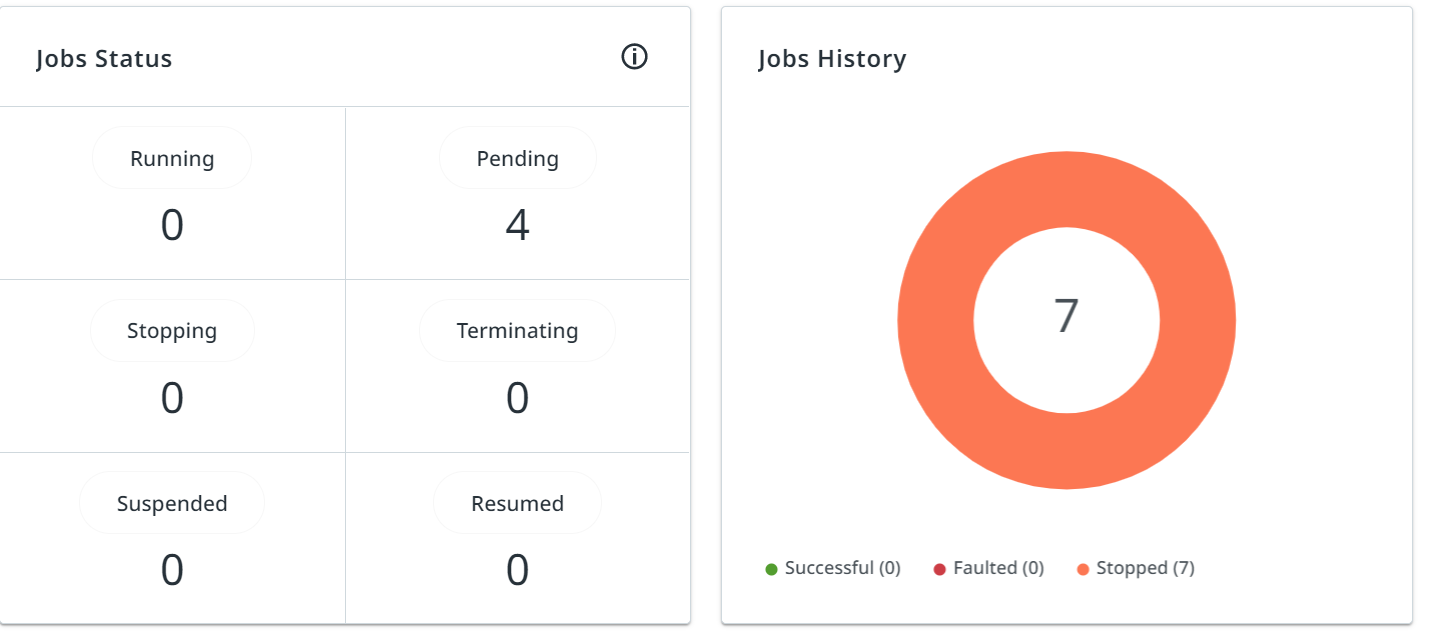

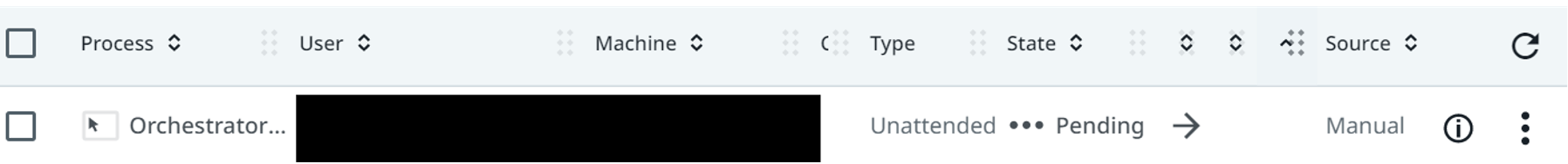

I am trying to run a job from Orchestrator, but it gets in the “Pending” state. Please find below the screenshots of the details:

Can you please check if your robot is busy executing any other job?
All the Jobs I have scheduled are in “Pending”.
Do you think Job details (Please refer to the earlier screenshot) are okay? Asking because there is no Environment name shown.
Didn’t you select environment while creating process?
Create the process once again with a proper environment and try job once again.

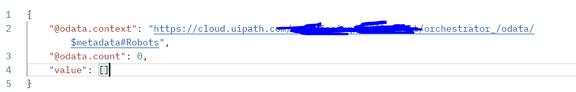

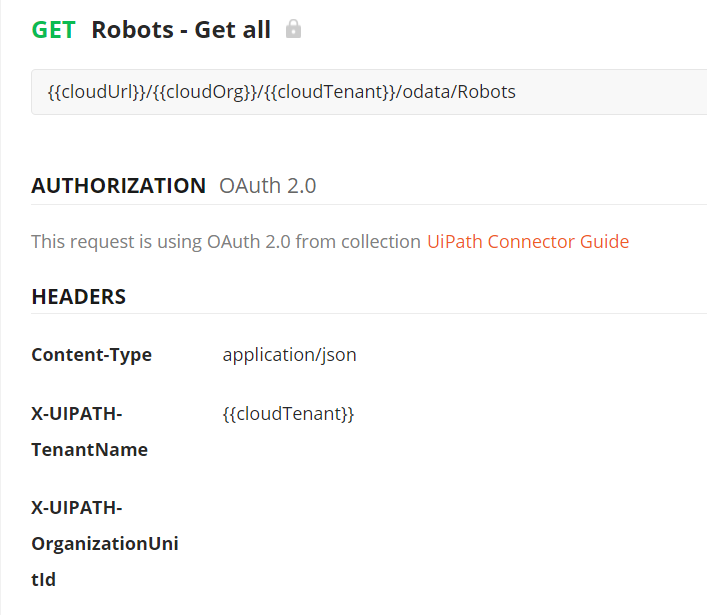

I have made some progress on testing orchestrator APIs. Struggling to get Robot ID.
I am making GET request from POSTMAN as instructed in below image.
I get following response:
You can see in above image that it returns no value.
But I have Robots available in Orchestrator. So i expect API to give values in response.
Do you know what might be causing this?

I’m thinking if you pass folder id as x-uipath-organizationid in headers , it may work. But I’m not sure.

Yes I passed Folder id.
API gave a response but value is empty.
Details of Robots were not returned in response.
Not sure what’s the problem. But try this alternative. Use /odata/robots at the end of your url instead of metadata.

Already Using /odata/robots

By the way, aren’t you getting output with /odata/robots?
It gives result as below.
if you see the yellow highlighted part, the value is empty. I am expecting Robot details there.
Probably I should look into other ways of finding RobotId. Please let me know if you know any.
Thanks!
But I see you are using metadata#robots instead of /odata/robots
ok. I’ll let you know if I find any solution
