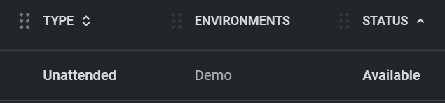

You might not have the license to run unattended bots.
Hi Buddy,
I used unattended bot only
