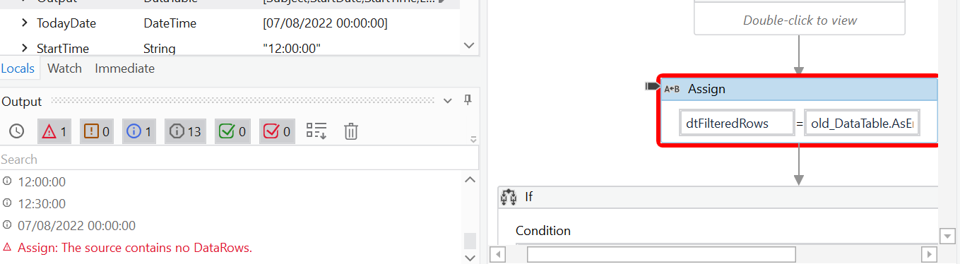

If I do the last edited version dtFiltered= old_DataTable.AsEnumerable.Except(dt_CommonRows.AsEnumerable(), DataRowComparer.Default).CopyToDataTable the result that I receive is:
and the old_DataTable has 3 results so I dont understand why it says null. If I do instead of old_DataTAble the second Datatable the one that has 4 results called Output Output.AsEnumerable.Except(dt_CommonRows.AsEnumerable(), DataRowComparer.Default).CopyToDataTable
it gives me all the result the 4 results of Output, I need only the one that is different.
handling empty return result
:ambulance: :sos: [FirstAid] Handling of The source contains no DataRows exception - News / Tutorials - UiPath Community Forum
