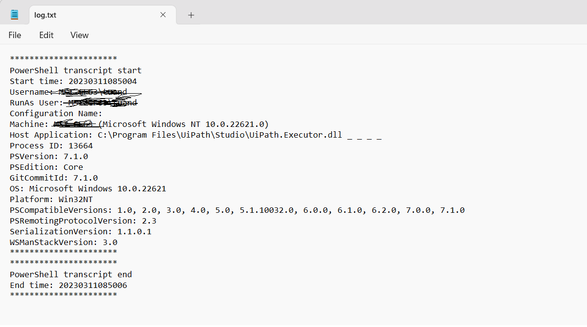

I am trying to write logs to a file when using the “Invoke PowerShell” activity, but I have not been successful so far.
$logFilePath = "E:\Test\log.txt"
$FolderPath = "E:\UiPath"
Start-Transcript -Path $logFilePath
cd -Path $FolderPath
php test.php --src $FileName --type $FileType
Stop-Transcript
Is there a way to do it?
