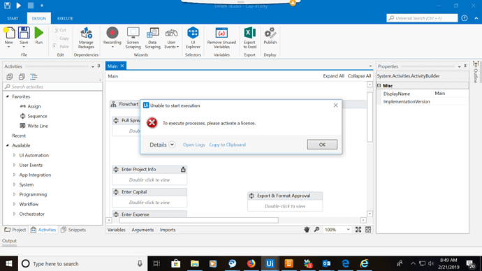

Issue Renewing License
I receive the following error message so I reached out to a UiPath rep and he extended my license. The issue I’m having is that I can’t seem to find the activation screen to begin the manual activation process since I continue receive the same error message. If I had just installed studio it would automatically pop up, but since it is already installed I can find how to navigate to it.
You can restart your studio and you should get the activation pop-up when it starts.
I have exited Studio and then restarted multiple times and that window does not come up unfortunately.

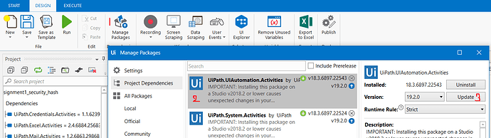

Not sure if a version issue. Can you update the UiAutomation package to the latest and try?
How do I update the UiAutomation package?
Steps 1 2 3 and then click on Save
I have completed all updates and restarted Studio, but I’m encountering the same error message.
