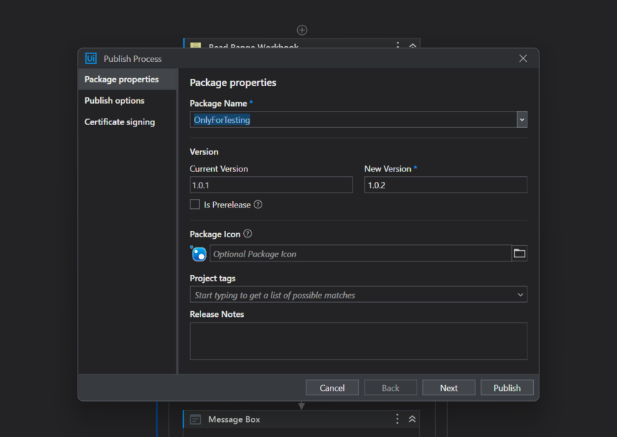

When you publish the package in windows project in the publish options you will see include pckages…uncheck it so that xamls are not published

@Anil_G Thank you so much, i found that option., now i am able to hide Main.XML file, if someone download that package from orchestrator they will not get the Main.xml file
