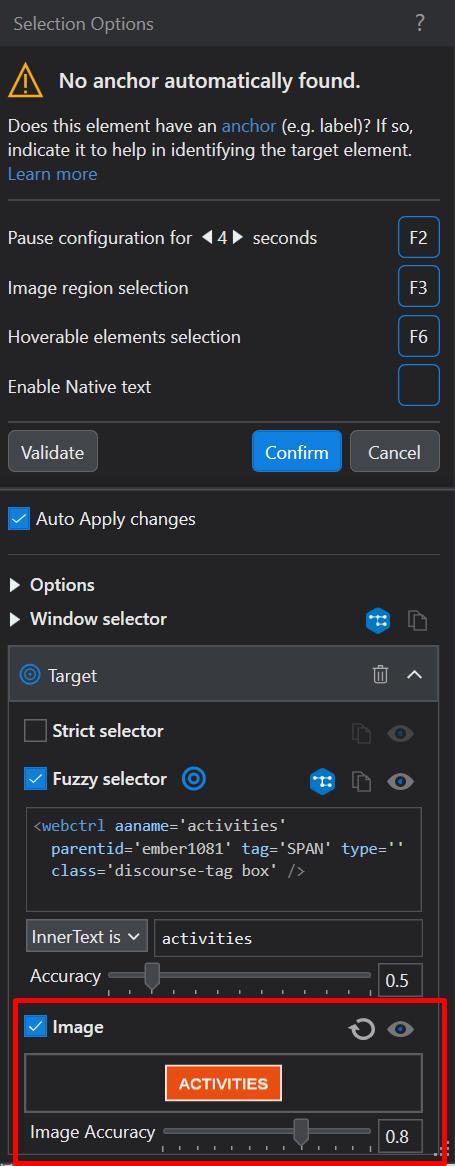

I want to know is there any difference while selecting the selectors that includes image as selectors.
For example This image :
I know that Strict, fuzzy & image selectors works simultaneously and which finds the target first will do its job but I really want to know When and where should I use image selector. Should I avoid it or should I use it ?
