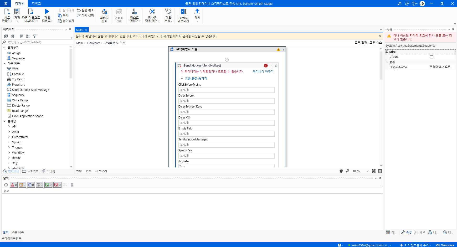

Downloading to use CheckAppState made my entire workflow weird. Can I revert?
The entire activity is like this right now. I have to return it to the state before download CheckAppstate. Or I have to discard the entire workflow I created.

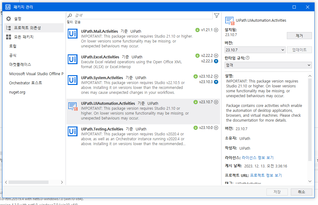

HI,
Did you upgrade UiAutomation package? If so,can you try to downgrade to previous version.
I create workflow based on UiPath.UIA Automation.Activities.If I go down to use the activity you told me, the existing activities are ruined. I checked the packages of other workflows and downloaded them again.
so i can’t use Check AppState.
