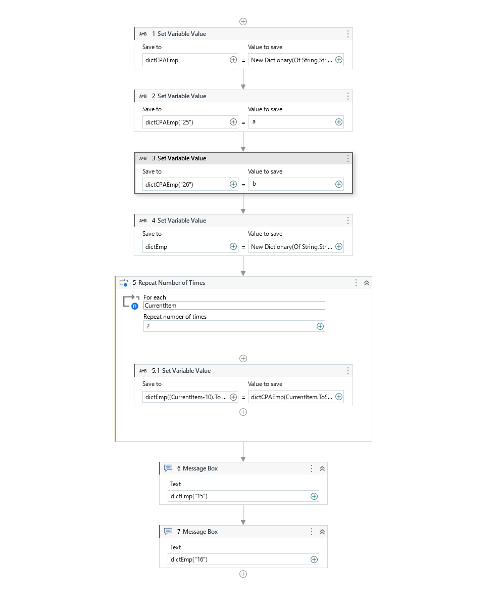

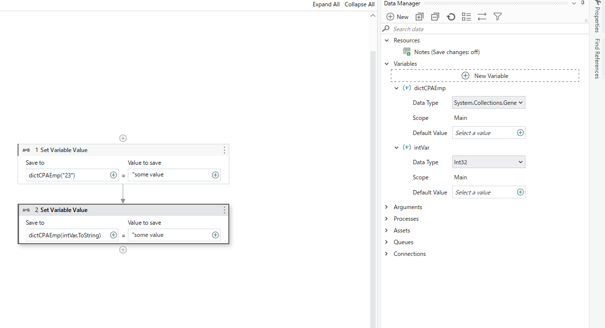

In this case, it might be better to use Dictionary<string,string> instead of each variable.
We can get or set it dynamically as the following.

HI,
Which version of StudioX do you use? In recent version, we can use any type variable.
The following is a simple sample regarding the above.
Sample20220330-1.zip (53.8 KB)
Hope this helps you.
