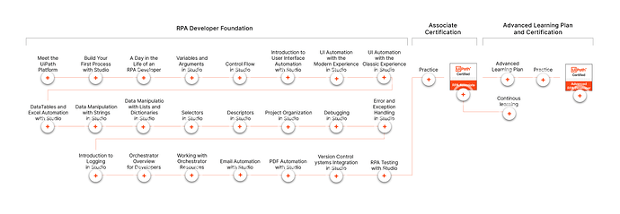

Hey,
Thank you so much for this, I just have a follow-up question. When I first started with the course “Meet the UiPath Platform” it introduced me to this which I am following:
Do any of those courses cover all of the workflow layouts? Do I need to learn all of them? If they don’t, can you recommend any courses which cover the workflow layouts?
Many thanks again,
I think it might cover those layouts, at least an idea, at courses: Control Flow, Project Organization, Debugging and Error/Exception Handling. But if you have time, would be good to follow the sequence to have a strong foundation (for example, variables/arguments, datatables, string manipulation, ui automation, they are all very important topics too).
