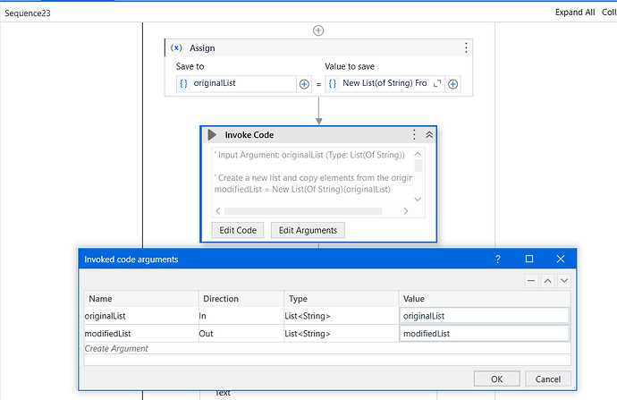

This example will help you out too
=>Give the below syntax in Assign activity
originalList= New List(of String) From {"A","B","C"}
originalList is of DataType System.Collections.Generic.List(System.String).
=> Use the below code in Invoke Code activity:
' Input Argument: originalList (Type: List(Of String))
' Create a new list and copy elements from the original list
modifiedList = New List(Of String)(originalList)
' Make modifications to the modifiedList
modifiedList.Add("D")
modifiedList.Add("E")
modifiedList.Add("F")
' Output Argument: modifiedList (Type: List(Of String))
Below are the Invoked arguments:
modifiedList is of DataType System.Collections.Generic.List(System.String). and it’s an Out argument. originalList is of In argument.
=> You can print it in Message box => below syntax prints the original list
"Original List: " +String.Join(", ", originalList)
=> You can print it in Message box => below syntax prints the Modified list
"Modified List: " + String.Join(", ", modifiedList)
Output:
Original List
Modified List
Check the below workflow
Sequence23.xaml (7.8 KB)
Regardss
