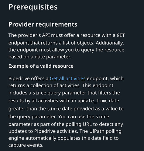

Does your response contain a date field?
If yes that field is to be added…something like createdtime etc
Also for trigger to work that field should support until or since parameters for date …that is the date paramrter should be in such a way that the trigger by dedault adds current time to it and it should get all items created till that time …and yhe next poll

The date parMeter with since option should be present …please check the example
