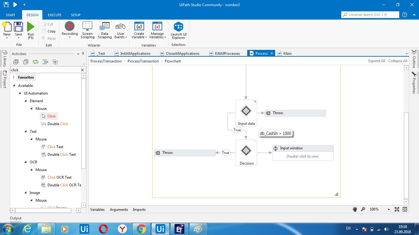

Diagram of the process of outputting information, all according to the instructions
Here, according to the instruction, information should be output from the queue, I think that there must be another component that was not described in the instruction that should receive data from the server
Here we check the input values from the queue
I have already looked through the instruction 4 times, everything is exactly the same as there
Is your queue and other assets created?
Not all steps are mentioned as part of the document.
When you get the error can you expand the details and see what the error is related to? put a screen here
Check your Configuration File and where your error is coming there what in_config(“Variable Name”) you are using. Cross check it exists or not.

Thanks a lot, found the error, the data in the configuration file
