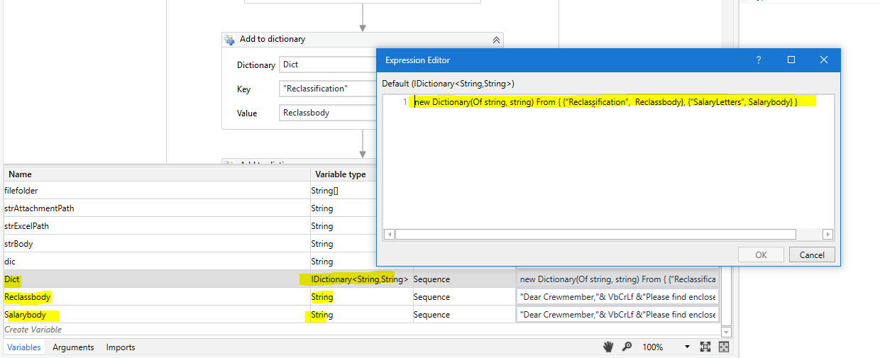

I Think this should be the solution but how to proceed ? I have the below error message when tring to run my process. What did I do wrong?

@mce
Dict variable should be of type System.Collections.Generic.Dictionary but you used IDictionary here.
Here, Error refers to Dict variable has not been initialized. Pass the default as below for Dict variable.
    New Dictionary(Of String, String)
I have changed the variable type to : System.collections.generic.dictionary
and pass the default as below for Dict variable:
I’ve got now another new error message (see below=)
What should I do to resolve this error message?
Thanks in advance for the help.

@mce
You should assign Input Dialog activity output to String variable but you are trying to assign it to dict variable because of that you are getting that error.
