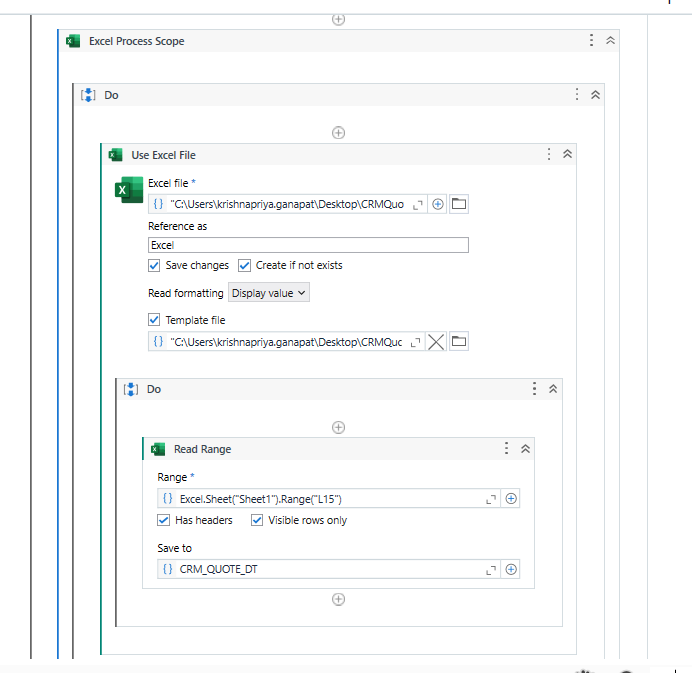

Is this a Correct process
HI,
It seems no problem. Do you still have format problem?
But While running the bot, why isn’t the bot entering the ‘For Each Row’ loop in the Data Table?
HI,
Can you elaborate? Do you mean CRM_QUOTE_DT is empty?
Try This Logic
validUntilDate.ToString(“dd-MM-yyyy”)
