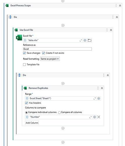

Another simple approach: can you try Remove Duplicate activity?
Sample
Sample20231124-3.zip (14.5 KB)

If you need to create new sheet which has only unique number, the following will work.
Sample
Sample20231124-3 (2).zip (14.6 KB)
@22222222asas
After reading the data just write it to a new sheet…the above formula are still intact

HI,
How about the following?
Sample
Sample20231124-3 (3).zip (14.6 KB)
