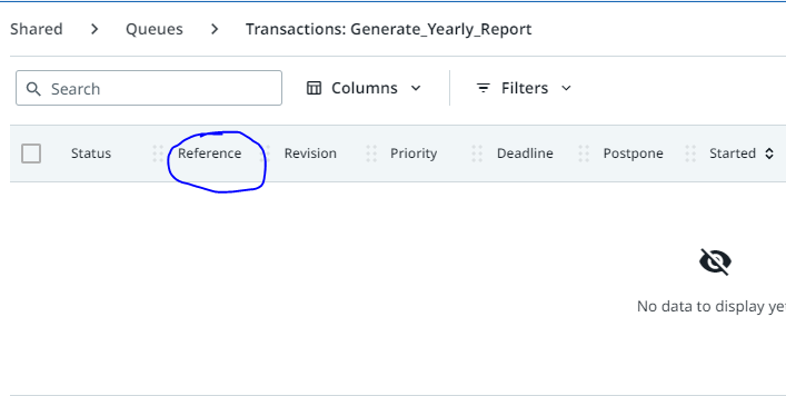

Hii @minal.patil ,
To do this You have to Enable the enforce Unique references while creating the queue.
Then let us say you have a data table to push into queue.Just add a new Column Named “references”
and add a Unique values to that column(if you have the unique columns in your datatable then uyou can take that column as a reference column)
Then while adding the queue items to the queue you can provide the column name here
Now if you go to your orchestrator, in the queue You can see there will be a reference column which is filled with the unique values which you added in your datatable while pushing the queue.
No need to worry about the added “reference” column in the datatable ,because the selected reference column will not be seen in the queue item it will bydefault set in the reference column of the queue .
This is one way how you can add unique references to the queue
Hope this might help you
