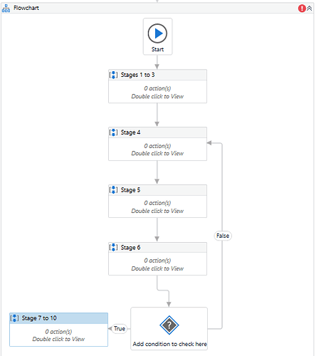

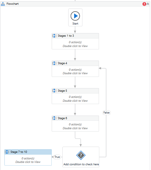

Hi @SH_94,
You could use a flowchart like that:

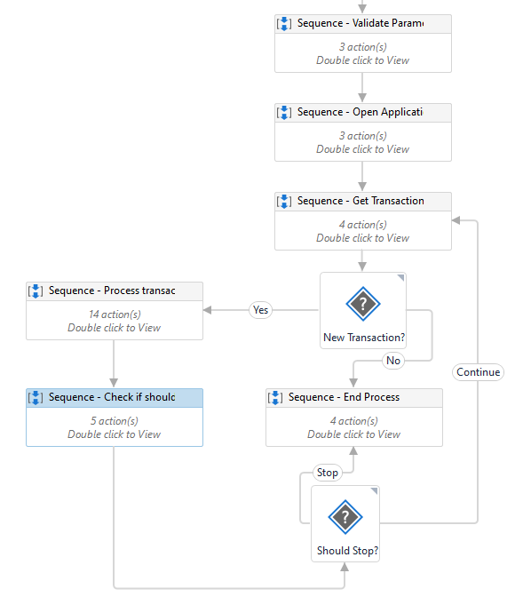

Here is a screenshot of a performer flow:
The benefit of this type of model is it makes both automations (dispatcher and performer) simpler. And using a Queue makes it simple to deal with what you need - skipping the rest of the steps for one item and moving to the next. It also makes it seamless if, say, your performer faults - when you restart it, it just gets the next transaction from the Queue - you don’t have to worry about figuring out where you left off in your loop.
