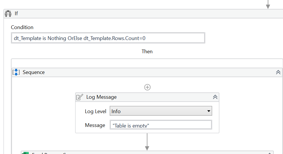

Hi All,
i have one issue, i have written that bot will check if there is no data in datatable, then it should execute then activity, but it always going to else part.
how to fix it
@RAKESH_KUMAR_Tiwari ,
Just put dt_Template.Rows.Count=0 and check
Did you check in Immediate pannel before entering to If condition that your dt_Template Count is 0?

Hi @RAKESH_KUMAR_Tiwari
Use this Condition in IF Activity.
Dt_Template is Nothing or Not Dr_Template.Rows.Count>0
This will surely work.
Regards
inside If condition
Just mention only one condition is enough for the scenario.
Dt_template.rows.count=0
Thanks

above if else there is a filter, i don’t know it is filtering the data, i can see that it has no records, but when i am counting the rows after filter it gives row count as 1.
1
  1. Check for multiple variables with same name
  2. Check from locals panel if data is coming
cheers
1.Kindly confirm whether the Datatable has record or not.
could u please take a screen shot of Watch table with the value of dt_template
so we can find the solution
Hi @RAKESH_KUMAR_Tiwari ,
Kindly check if the data table you are referring to has data by debugging.
yes, it was refering to different one, thanks, working fine
