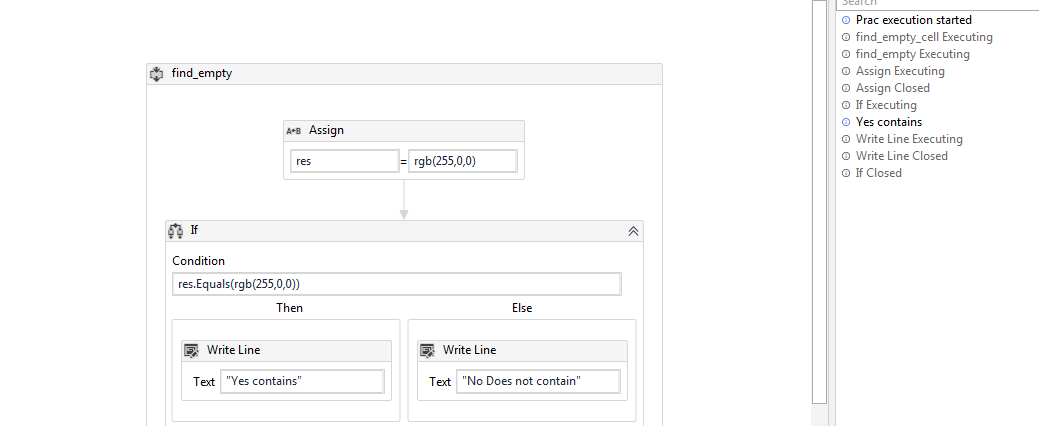

in result variable I am getting value rgb(255,0,0)
and I am applying condition if(result="rgb(255,0,0) ") this move to inside if condition but in my case it move else I also try this if(result=rgb(255,0,0)) but not work

HI @Aditya10989 ,
If the variable datatype is string then you can use result.contains(“rgb(255,0,0)”) it should works.
Thanks,
Mohanraj.S
Hi
If this is the value we obtain
Then to be precise we can use a condition like this
result.ToString.Trim.Contains(“rgb(255,0,0)”)
The reason is might be failing due to some blank spaces either in front or back if the mentioned string
—if the above condition passes it will go to THEN part of if condition or not will go to ELSE part of if condition
Hope this would help you
Cheers @Aditya10989
