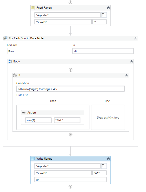

@Jayavignesh_G …try cdbl(row(“Age”).tostring) < 4.5
cdbl - ??
convert.todouble
@Jayavignesh_G - Please check my output here…
My workflow…
Hope this helps…
Output if i compare the numbers as string(which you should not)
@Jayavignesh_G - please let me know if the above solution is working for you?
Yes It is working … Thanks !!
