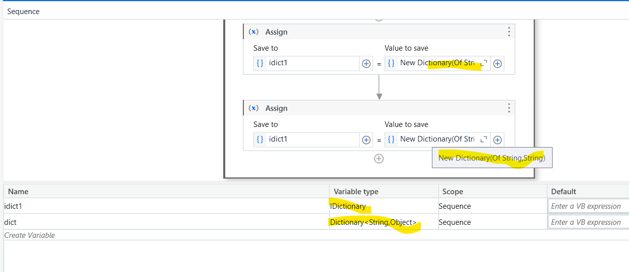

IDictionary型変数とDictionary型変数の相違点
UiPath Studio 2023.10.0 EnterPrise Licenseの初心者ユーザです。
IDictionary型変数とDictionary型変数の相違点をChat-GPTで調べたのですが、違いがよく分かりませんでした。
初心者の私でも理解できるように説明できる有識者の方、いらっしゃいませんでしょうか。

@gorby
Please check this
c# - A difference in style: IDictionary vs Dictionary - Stack Overflow.
To summarize an interface is not toghtly coupled to the type…so if the type needs to change then interface provides an easy way than the class
Interface is nothing but an abstract class…means there would be methods but the implementation of those wont be present…it inherits from the declared type

@gorby
please try to learn about interface and classes that might help you understand
Example say you decalre a dictioanry as a variable type the dictioanry type is to be fixed you cannot change…but if you declare an idict it can be changed easily and would not effect your implementations
