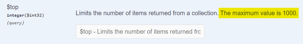

You are not able to query that many entries at once, you will need to split your request in batches of up to 1000 IIRC. So again, timeout should not be a problem (use top and skip parameters to implement paging)
What’s the maximum number of entries I can query at once?
There is usually no limit on data that can be fetched. The data obtained is usually suggested to be max 1k, so that you will get the data for processing early for execution.

Just take a look at swagger for the specific entity you are interested in.
Did you mean if we want to fetch more results, do we need to increase timeout?
I have never tried it, but @qbrandon is showing data from swagger, so I assume he would be correct in this scenario :slight_smile:
