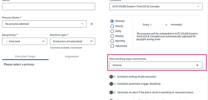

  1. Create custom calendar in orchestrator for weekdays per your organization’s holiday calendar, so it doesn’t have any holidays/weekends.
  2. then choose that custom calendar while creating CRON expression and specify every 7th day.
That should help you :slight_smile:

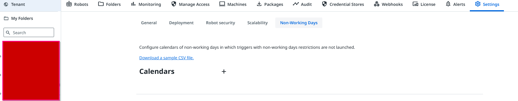

  1. to create a calendar, go to below location:
  2. Once created, select that calendar from trigger section, and provide cron expression. for example below cron expression would start process 7th day, likewise you can customize per you need(time/day etc):
    0 0 0 7 * ? *

I’m pretty sure the result of this is if the 7th day of the month is a Saturday or Sunday, the calendar will block it from running. I don’t think the trigger combines the cron expression with the calendar to find the 7th working day on the calendar.

I dont think so.
Custom Calendar here refers to the calendar with only weekdays(no holidays/no weekends included). so now if cron expression is configured to run on 7th day of that calendar, that is essentially 7th working day.
But again, that is something, @Gopi_Krishna1 can configure, implement and confirm the results for.
That’s not how it works. There is no connection between the CRON expression and the calendar, as far as I know. It’s not parsing the CRON expression against the calendar. The CRON expression just determines when it tries to run - no different than if you manually select certain days in the trigger settings. If one of those days is not a working day according to the calendar, it just doesn’t run that day.
Hmm.. I think you may be right there.
If we were to run automations only on working days, then this approach would totally fit.
I will try to run some tests on my end as well to observe the behaviour.
Thanks.
