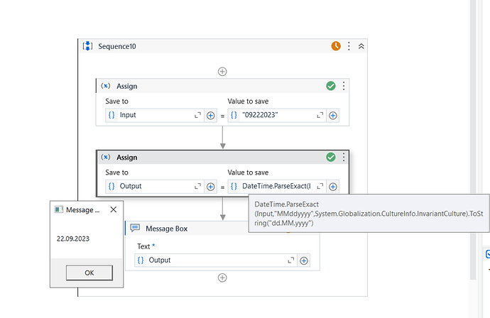

Suggest suitable expression to get the required output, its a string Variable type, Thanks i n advance for your help
Input= "09222023"
Output= DateTime.ParseExact(Input,"MMddyyyy",System.Globalization.CultureInfo.InvariantCulture).ToString("dd.MM.yyyy")
Hope it helps!!

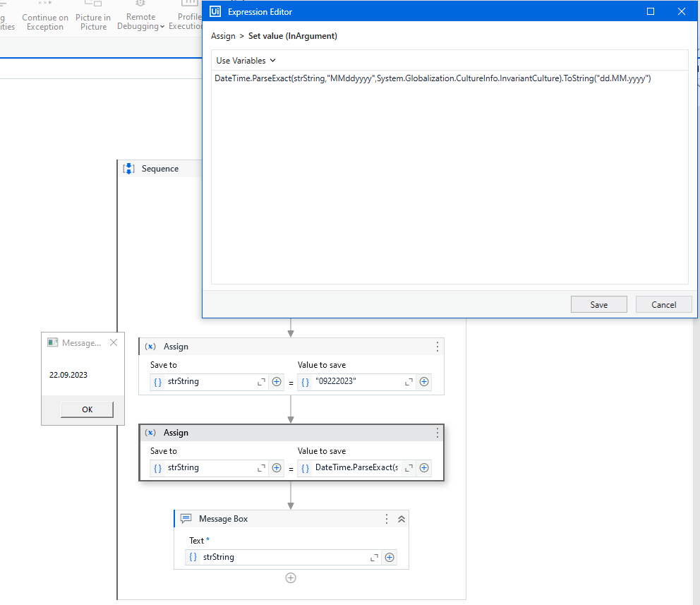

it’s double quote matter of Windows project. Can you try to use (copy and paste) the following expression?
DateTime.ParseExact(strString,"MMddyyyy",System.Globalization.CultureInfo.InvariantCulture).ToString("dd.MM.yyyy")

Try this
your issue is double quotes , you can copy and paste in assign activity below one
Getting the Required Output Thank You ![]()
