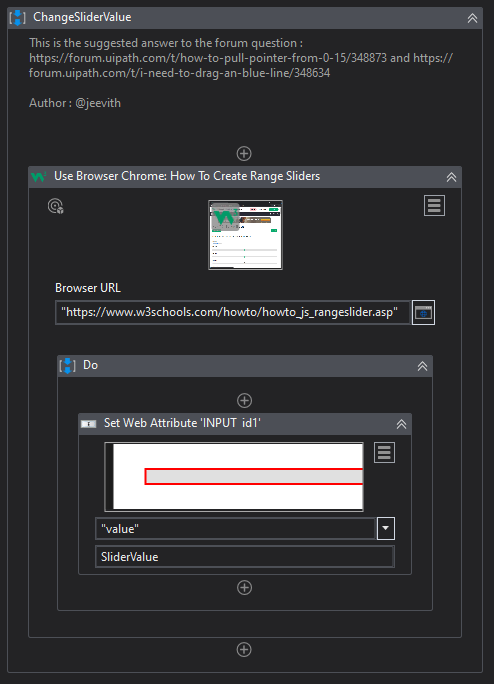

Hi @manipreethi410 and @Shiva_Kumar1,
Here I use the modern expierence in UiPath studio but you can use the older way of browser automation as well.
As an example slider I use this website : How To Create Range Sliders
In this case the selector attribute which need to be changed is "value". In your case you have to find out which attributes need to set.
The round slider changes from 50 to 75.
Sample xaml file : ChangeSliderValue.xaml (11.0 KB)

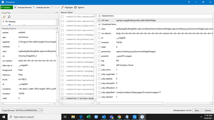

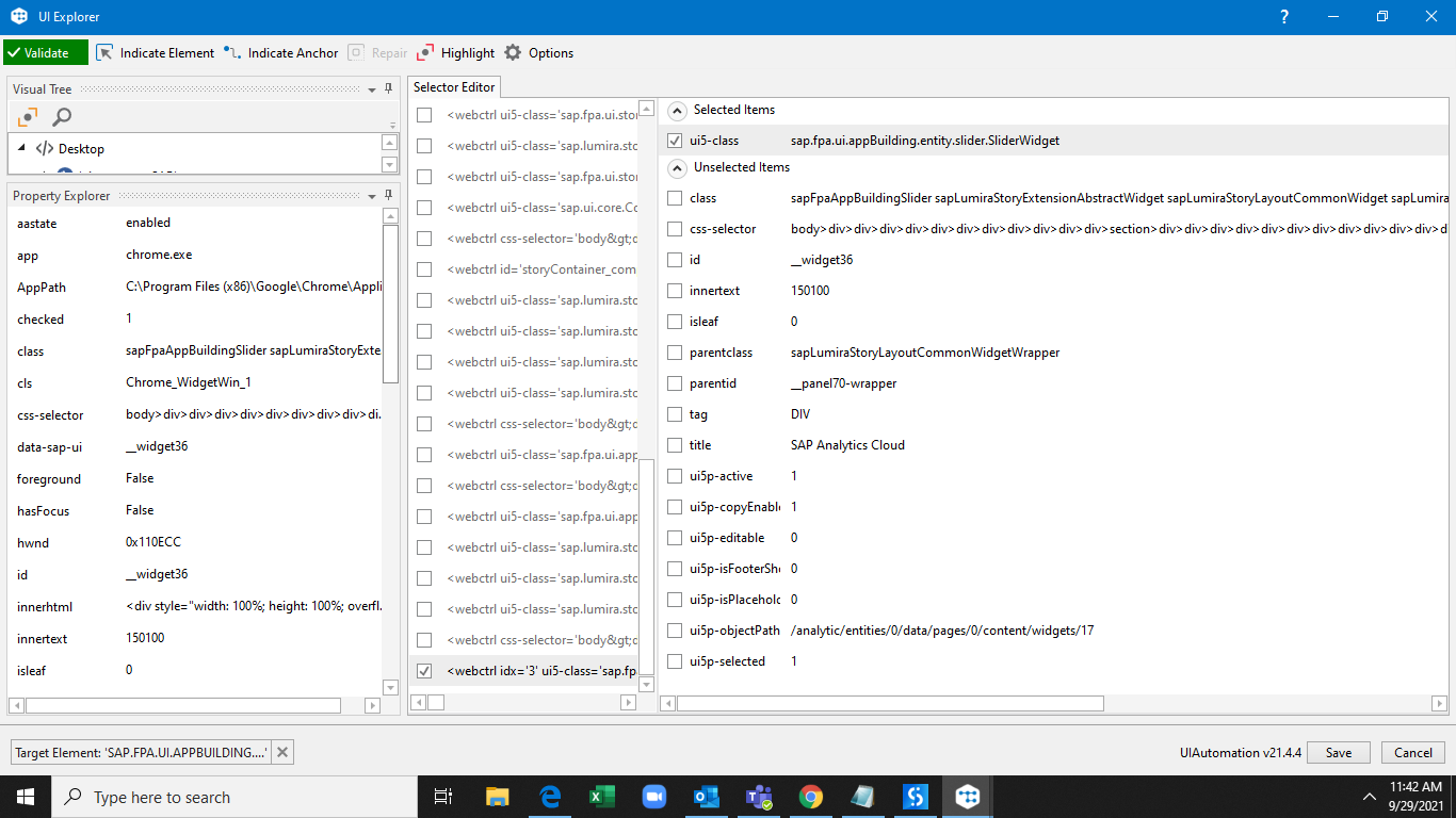

this is the selector.
this is the selector which i got form the UI.

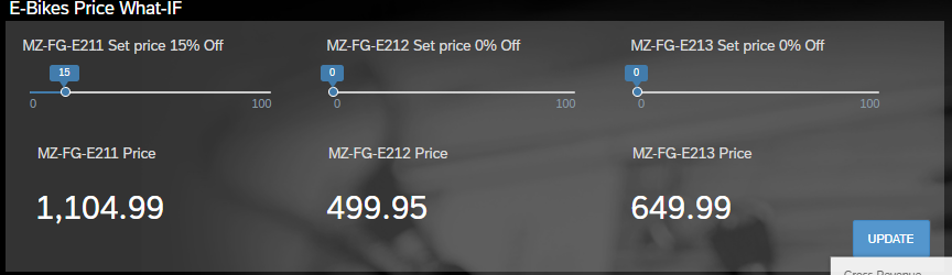

I was able to reproduce it in SAP demo environment, on this page SAPUI5 SDK - Demo Kit
I am moving the slider without any issues with this approach:
it is a simple click with Offset in X, then it will click on the place you want.
Please let me know, if it works for you?
