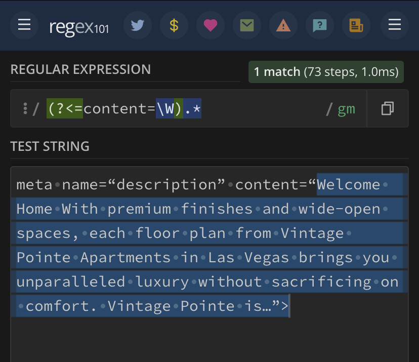

Let’s take a simple expression
(?<=content=\W).*
Hope this would help you

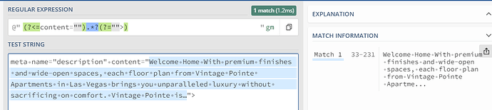

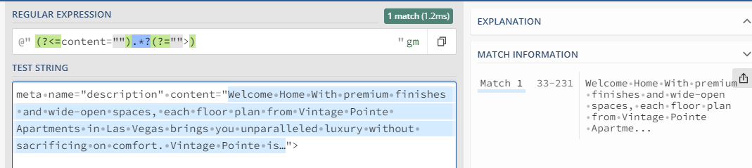

Hi @deepankar ,
Maybe you could try with the below Expression :
(?<=content="").*?(?="">)
Regex.Match(yourStringVar,"(?<=content="").*?(?="">)").Value.ToString
You would also have to import the namespace System.Text.RegularExpressions to use the above Expression.
