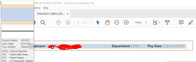

I have 4 payslips , the selection works but selecting multiple sections
  1. flow works
  2. 4 pdf opens

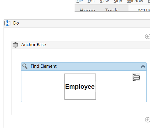

  3. find element- pdf name adress is getting selcted together, not individually,
    SAME GOES FOR OTHER META DATA AS WELL

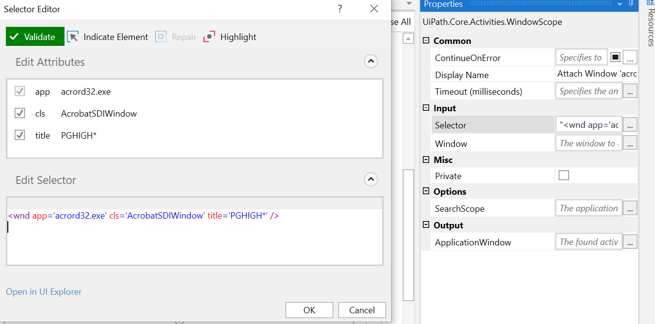

when it is selecting extra area consistently, please edit your selector and see. Change idx=1, 2,3 etc and it will start looking at different area on the page. Please give a try.
alternately, pick up the same selector if it is consistent then use string manipulation to separate your desired value.

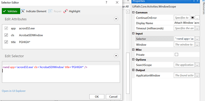

I am new to UI and struggling to change the idx values
can you take screen shot of your selector and paste hear. ppl from forum will help you
can i use image informative screenshot to find the element?

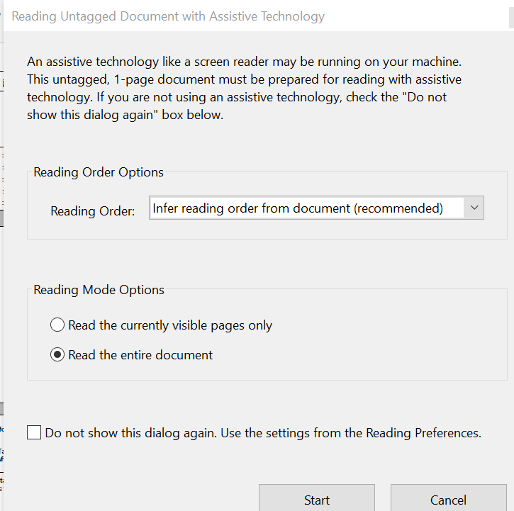

does not even show tagging reading option
