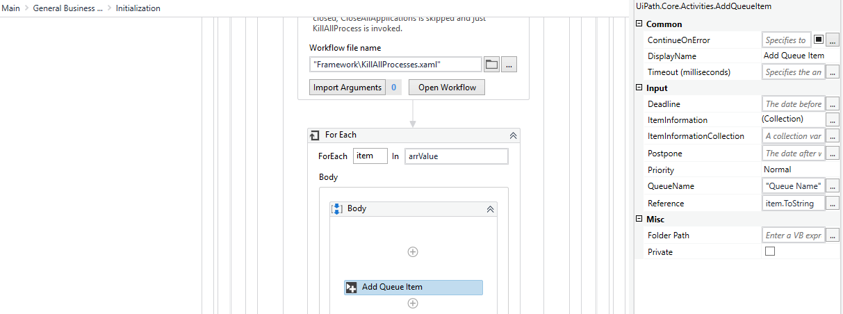

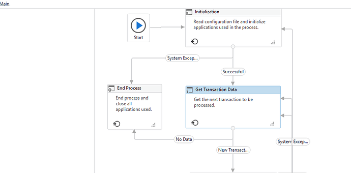

Let’s assume this is your reframework.
Load your arrvalue in init state like shown below
Once all items get loaded, it will start processing get transaction and then process state and will continue till all the items get completed.

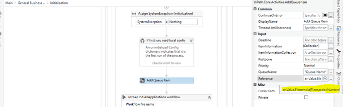

but then it will load all at once (A,B,C) i dont want that i want first load A in queue to go get then process it …
again come back to B load in queue go and process that
again C load in the queue and process
But why you want to load one by one, any specific reason ?
Then use it as below below outside if condition
Don’t forget to give default value of Transaction Number to 1.

My bad done some mistake, will send you workflow again.
Hi @Shivangi_Patankar ,
Try below framework designed as per your usecase.
RoboticEnterpriseFramework1.zip (986.1 KB)
Note: Give your queue name in config.
this is not working as array variable value need to be pass one by one and process one by one not at once
Array value is not passed at once it is adding on the basis of counter value.
This is what you said earlier to add each queue item one by one from array.
