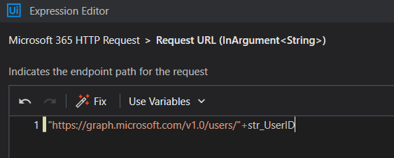

Here is my endpoint:

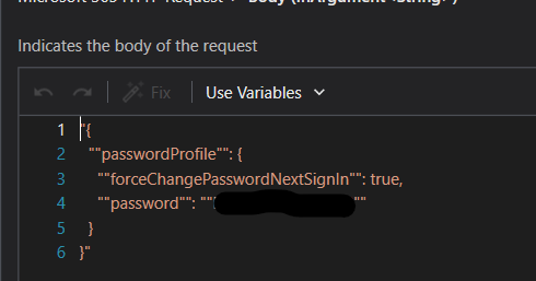

And here is my body:

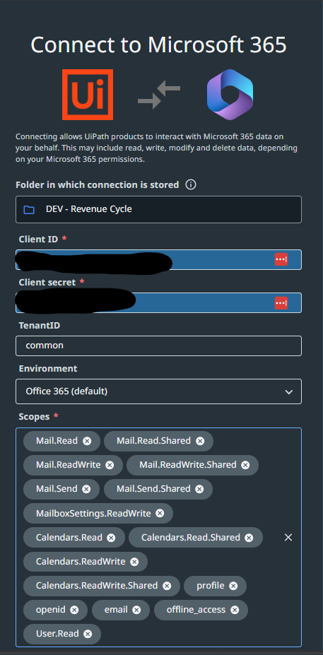

Could it be that the permissions for the connection pictured below, are the only permissions that can be delegated through the M365 integration Service connection?
@mahenry
Ideally yes if it is missing..becuase hhtp request is not available for microsoft connector if that is available then all scopes are exposed
Try clicking inside the Scopes control and they type the missing permissions. If you have them on the App too, they should work.
