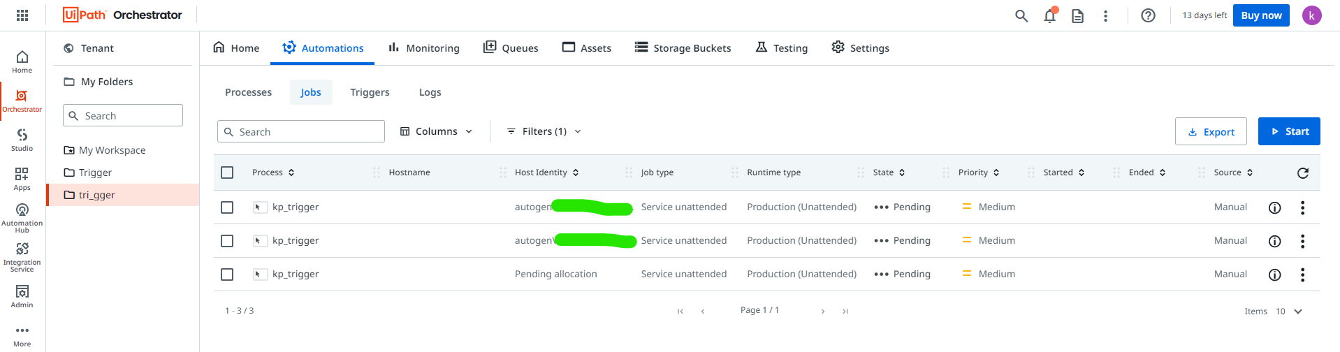

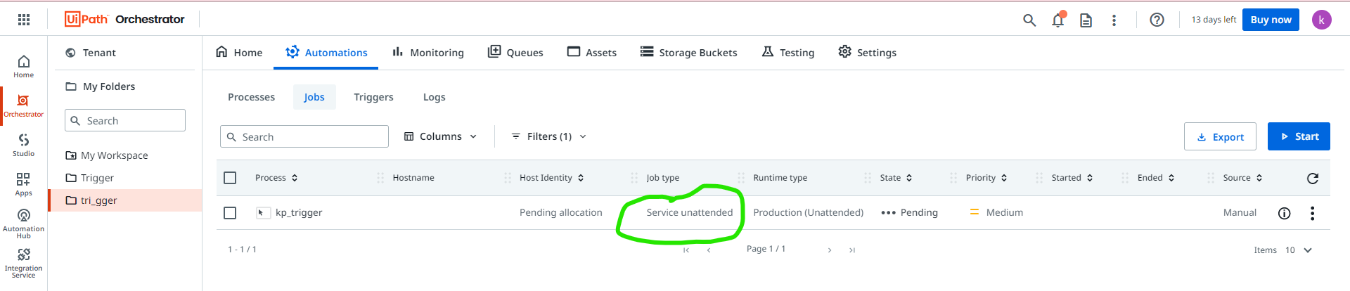

I can't able to create the job

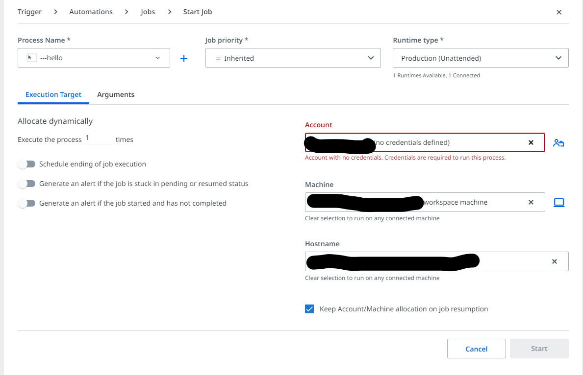

Hi @krishna_priya1 ,
Refer to the following thread:Account with no credentials. Credentials are required to run this process

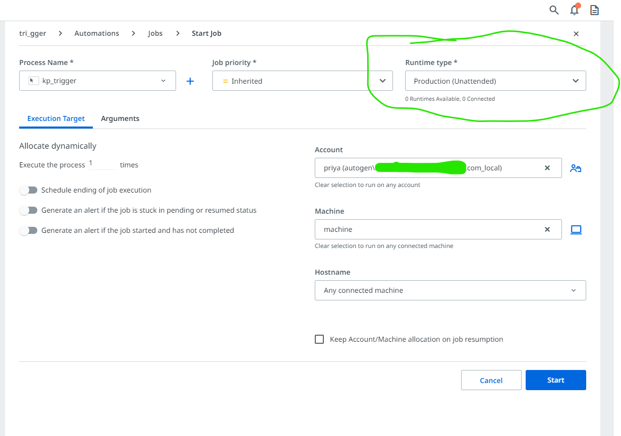

Hey @krishna_priya1
You need to set the unattended machine. You can add machine Template choose 1 unattended machine then you can use it in the process.
Check this out
https://docs.uipath.com/installation-and-upgrade/docs/deploying-unattended-enterprise
Hope this helps.
Cheers.

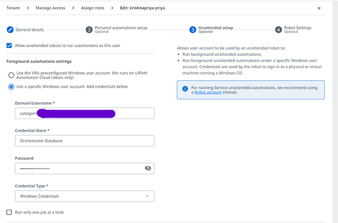

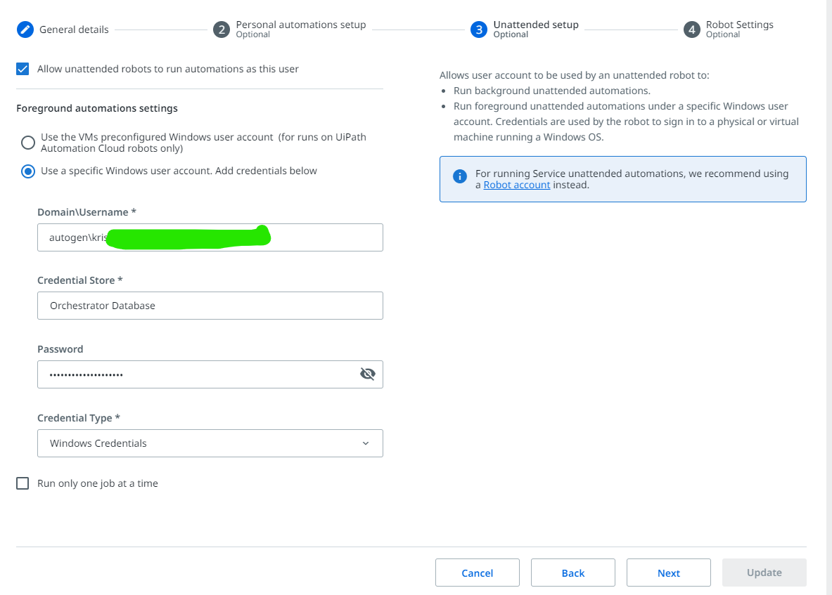

This is correct?
Yes @krishna_priya1

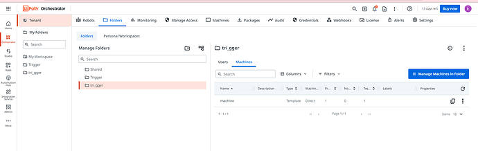

Hey @krishna_priya1
Is it working for you ??
I think you have successfully added the machine, then it should work for you. If it is in pending please check again you might have missed on something.
@krishna_priya1
Select hostname others look good to me.

Hey @krishna_priya1
Ok let that be its ok.
In the orchestrator assistant
Go to preference
Orchestrator settings Then signout
Chenge connection type to machine key
Enter machine name and orchestrator url also machine key you get this from orcestrator( Tenent – Machine – Edit unattended machine – Copy machine key).
Then click on connect
Try this hope it will work.
