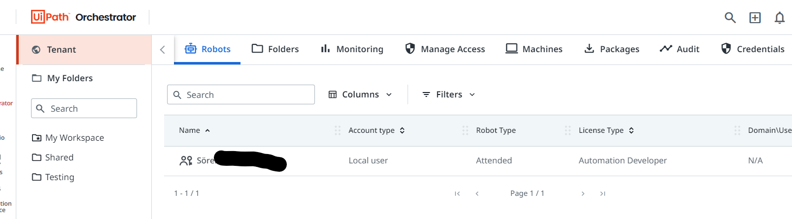

There is only one Robot shown. But I do not think it is the right one - is it?
