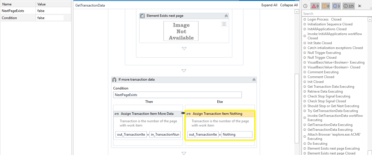

I am working on Assignment 2. while debugging what I am getting is
when run the main.xaml in debugging mode for dispatchers the process goes to Init state then it goes to the GetTransaction state and in the GetTransactionData workflow it’s not giving the value it’s going in the else part.
What is the selector for ‘nextpageexists’?
“< webctrl aaname=’”+in_TransactionNumber.ToString+“’ tag=‘Ll’ />”
This is using in checking the next page and I am using this selectors in the element exist activity.
I think here is the issue robo not able to find the page is it
you are using the correct selector. But, yes you are right, it is not getting the next page, thatswhy it is going to ‘else’ condition.

You have not stored the output of ‘onelementexists’ in any variable (ideally in ‘NextPageExists’).
Then how are you using variable ‘NextPageExists’

row(“Type”).Equals(“W14”) and row(“status”).Equals(“open”)
It’s not ‘W14’ but ‘WI4’
