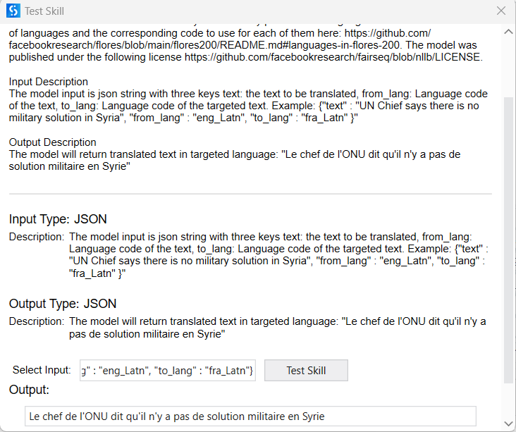

When I enter the input in the test skill {“text” : “UN Chief says there is no military solution in Syria”, “from_lang” : “eng_Latn”, “to_lang” : “fra_Latn”} it gives output
But Now what to enter in the input of the ml skills
to Get Desired out put to show

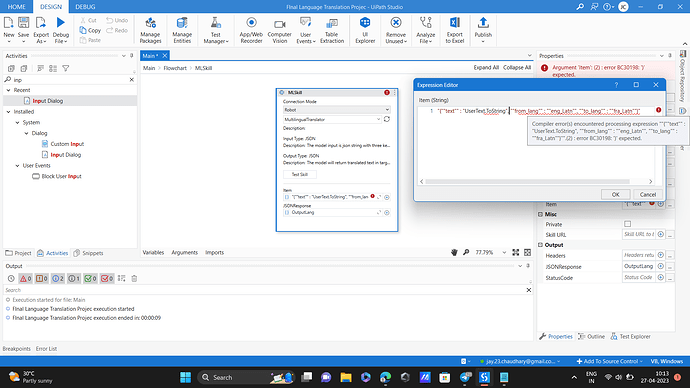

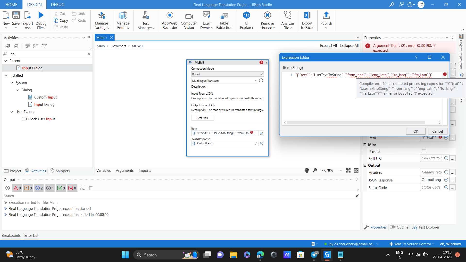

Sure sir ,This is the input item which is given on the item
![Screenshot (259)|690x388](upload://4YWgIeXggYLoOVZcBzLuqaupOmS.png
Please tell me what input should i give to get out put
AND INPUT ITEM I HAVE GIVEN INPUT THIS
{“text” : “UN Chief says there is no military solution in Syria”, “from_lang” : “eng_Latn”, “to_lang” : “fra_Latn” }
this is the sscrenshot

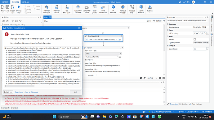

Using Deserialize Json acivity(under UiPath.webapi.activities) to convert the string to jobject this leads to this error
@Jay_Chaudhary
Please use this…i see your inverted comma are wrong and also inverted comma has to be escaped
"{""text"" : ""UN Chief says there is no military solution in Syria"", ""from_lang"" : ""eng_Latn"", ""to_lang"" : ""fra_Latn""}"
Thank Your sir It worked very well
