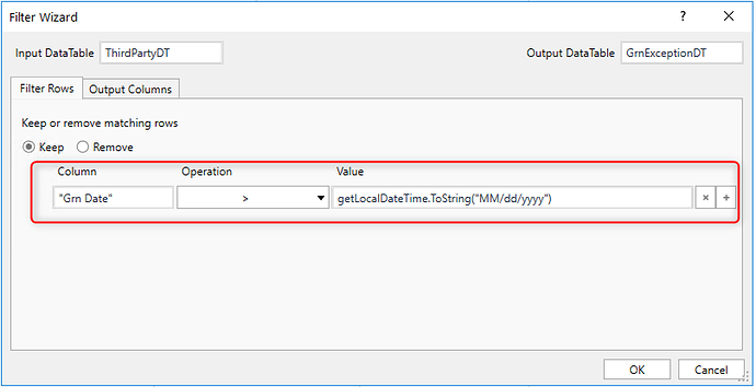

I am not able to filter on date in a data table
Hello Friends,
I have situation where I download data from SAP and in the data table I do a filter on the date for a certain condition there is no output in the new data table.
The Grn Date is in TEXT format when it is downloaded. I changed it to DATE format or to General and tried it did not work for me.
I am attaching a sample file.
Test_Date.xlsx (9.8 KB)
Appreciate your valuable tips/thoughts on the same.
Manjesh
If “Grn Date” is a datetime (which is what you want) then you don’t do .ToString(“MM/dd/yyyy”) in the Value box. Just do getLocalDateTime (which is a datetime, not string, value). You have to compare like datatypes - so both the Column and the Value should be datetimes.

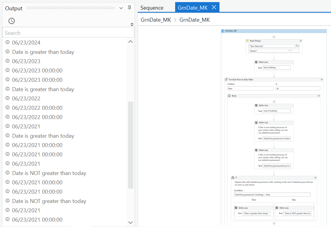

@manjesh_kumar - Please check this…
GrnDate_MK.xaml (8.5 KB)
Note: After reading your sheet, first use a for each and print the date column value to see how it is printing first. Based on that you have to decide your code for Datetime.parseexact, it will always easy if you do this way.

@manjesh_kumar - you didn’t use the LINQ query screenshot which I provided ? The for each loop thing is just to show you how the date format works for the data you shared.
Hello @prasath17 ,
I tried the linq query, it is giving an error.
Manjesh
@manjesh_kumar - Whatever the date you provided it is working fine for me…
GrnDate_MK.xaml (12.0 KB)
As i mentioned in the steps clearly, please print the date from the column and see how it is printing, based on the use the datetime.parseexact…

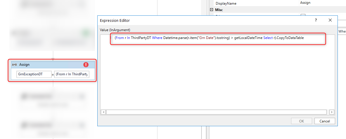

Hello @manjesh_kumar
you can try this—
ThirdPartDT.AsEnumerable.Where(function(r) Convert.ToDateTime(r(“Grn Date”).ToString)>GetLocalDateTime).ToArray.CopyToDataTable
or
this—
ThirdPartDT.AsEnumerable.Where(function(r) DateTime.ParseExact(r(“Grn Date”).ToString,“MM/dd/yyyy”,System.Globalization.CultureInfo.InvariantCulture)>GetLocalDateTime).ToArray.CopyToDataTable
Hello @pravupada ,
the same error is repeating. I tried both.
Manjesh
