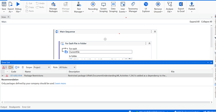

I am getting restricted package error while running my workflow
i am unable to run the project in which i am trying to digitize the pdf files and using
UiPath.documentUnderstanding.ml activity package .

It is a worklfow analyzer rule…either modify the rule or you can disable the rule check as well…click on analyze file dropdown and select workflow analyzer settings and uncheck the rule
cheers
Hi @ankur.kaushik
In the Project Settings window, select the Workflow Analyzer tab. Find the rule and select the rule, as in the image below:
Check this for ref
https://docs.uipath.com/studio/standalone/2023.4/user-guide/st-usg-014
Thank you so much,it worked now
